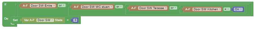

I have made this event, it must check if one of my door switches are left open - but it's only the last switch in the "IF" chain that will react -
Why does it do this?
Why is this event not working

I don't use blockly events..but i think you would add the right comparisions...
if "Door Sw.." = On or Door SW WC Stuen.. = On etc..etc..
and not
If "Door Sw.." or Door SW WC Stuen..
and not

You have to say for each switch what you need it to be before it triggers, so change it to:
If [Door SW Entre] = [On] or [Door SW WC stuen] = [On] or [Door SW Terasse] = [On] or [Door SW Kitchen] = [On]
Do ...

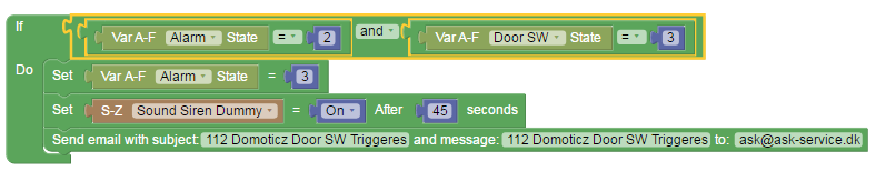

I have two variables:
"Alarm State" which is = 2
and "Door SW State" which is = 3
The script stops here. This means that it does not accept the statement ???
What am I doing wrong with this "Event"
If anyone understands what I am trying to do.
How will it look like in LUA?
Best Regards Allan
Please Help
Best Regards Allan

with Blockly (or even Domoticz altogether) you can't set the same variable which you already use in the if-statement. I believe it was because of preventing loops.
Replace in this blockly the variables with dummy switches and you'll see it'll work just fine
