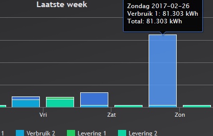

Last sunday i updated to the beta version of Domoticz again (i was using the stable version) and i noticed that :
  • - i am getting every second a reading from the P1 meter. (my status logs only show P1 smart Meter readings :cry: )
  • - i had a abnormal reading in my electra
I was curious if anyone else experiencing these kind of behaviour?
