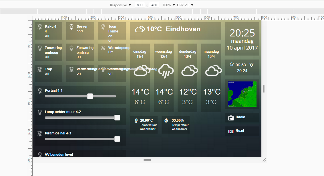

I wan't to use the dashboard on the original raspberry touchscreen which is only 800x480, is there a possibility to change the fontsize overall to a smaller percentage? I'm testing it in google chrome with the 800x480 (don't have the screen yet). If i do it with the css I have to change it for every item while I wan't the whole system to use a smaller percentage.

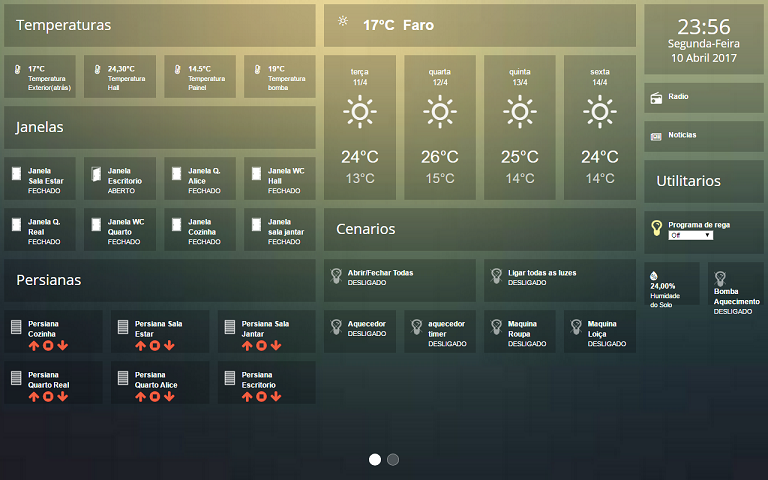

this is my dashboard until now, screen taken on deskop, i have maked change on door contact image, the last was a little confusion for me.
only the select switch not working like said before.
http://imgur.com/a/LRwDY
