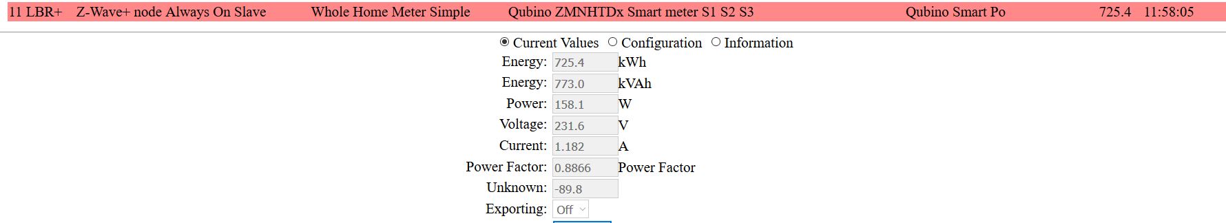

Can you make a screenshot of what you get and then tell me what you expect?
mazgon
- Posts: 21
- Joined: Friday 30 December 2016 8:26
Re: Three minor issues with the Qubino Smart Meter (ZMNHTDx)

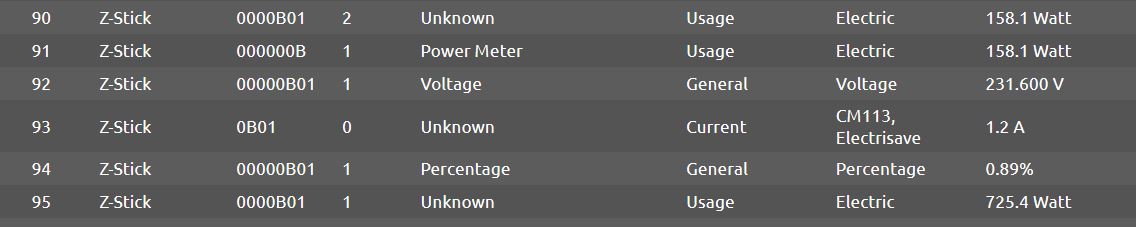

into the attached files you have the information that I have from the zwave control panel and the information that I have from the devices....tlpeter wrote:Can you make a screenshot of what you get and then tell me what you expect?
So the main problem I have no kWh reported, I have the kVA reported with the wrong unit of measure, Watt, and no historic information....
- ozw control panel.JPG (57.05 KiB) Viewed 4585 times
- devices.JPG (39.35 KiB) Viewed 4585 times

I do not understand. 95 is showing what need if i am correct.

The 95 is expressed in watt instead of kwh and you have just the current value, not the history logtlpeter wrote:I do not understand. 95 is showing what need if i am correct.

The first screenshot says kWh. If this is wrong then try sending an email to qubino. Maybe they know.
