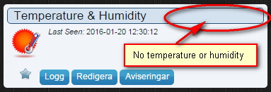

The log is showing this:
The virtual sensor is showing nothing:
The actual virtual sensor values after running LUA-script (from “show current states”):
What could be wrong in LUA-script?

Did you use the Temp+Humidity virtual sensor ? So it's only 1 sensor and you must send Temp & humidity in the same svalue like explained here : https://www.domoticz.com/wiki/Domoticz_ ... 2Fhumidity
What you have in log : 21;45 is exactly what you need to send to the sensor. No need to get strings to convert them to numbers to convert them back to strings ;)
This will be done with only 1 command. Something like that :

Many thank's jmleglise :D Your script code example works great. Now I can combine the temp and humidity values in the same virtual sensor instead of having separate virtual sensors for each one I've had before.
Yes, I used a Temp + Humidity virtual sensor when I tried to get the LUA code to work and was a bit desperate to make it work :lol:

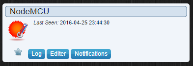

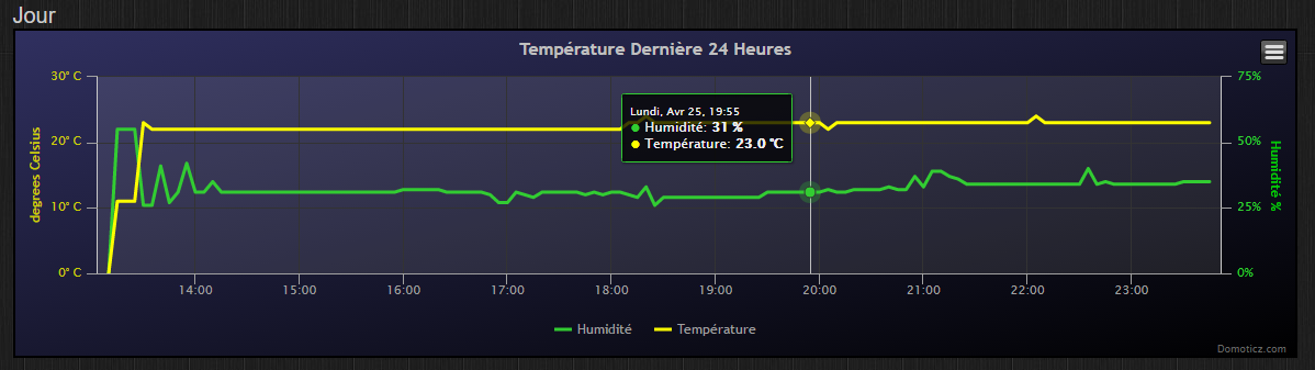

I alsoe have the same issue with the virtual device.
He doesn't display temp or humidity.
I'm using a NodeMCU to call the json api of Domoticz.
Update is working fine and graph also but there is no value display in the temp tab.
Here is the graph:
And the device row:
Thank you.

Ok, I figure out why.
In my API call, I haven't set the HUM_SAT parameter.
So that's why.
I used this:
http://192.168.1.254:3434/json.htm?type ... alue=23;35
Instead of:
http://192.168.1.254:3434/json.htm?type ... ue=23;35;0
Do you know how to get the HUM_SAT value ? Is it a calcul or something ?

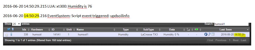

I have a simular issue.
The humidity gets scrapped correctly from the actual sensor (and diplayed in the log)
But when it comes to writing the value to a virtual Humidity sensor it fails.
The logs show that the sensor gets updated, but with a 0 instead of the earlier read value.
any suggestions anyone?
bodem = 'soil1'
vsenshum = 'humsoil1'
vsenshum_id = '338'
   smoistsensorTemp, smoistsensorHumidity = otherdevices_svalues[bodem]:match("([^;]+);([^;]+);([^;]+)")
   smoistsensorTemp = tonumber(smoistsensorTemp);
   smoistsensorHumidity = tonumber(smoistsensorHumidity);
 print("xt300: Humidity is " .. smoistsensorHumidity .. " ");
    commandArray['UpdateDevice'] = vsenshum_id .. "|0|" ..smoistsensorHumidity
return commandArray
