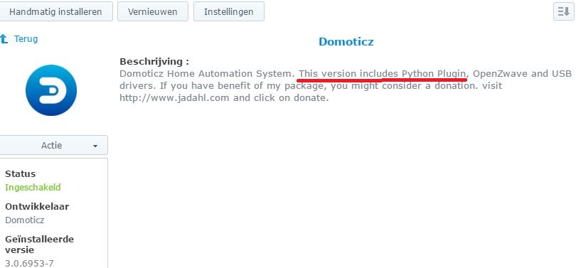

Still trying to get this to work.
Domoticz is running, and is in DiskStation:/volume3/@appstore/domoticz/ and the buienradar is in DiskStation:/volume3/@appstore/domoticz/plugins/buienradar
Restarted domitcz with
var/packages/domoticz/scripts# ash start-stop-status restart
Still no hardware found. I think this is a beta version of Domoticz version 3.6953.
Tried some of the things written in here, but still no luck.c
