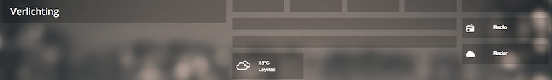

Re: New Dashboard Design
I did a clean install,
FiIled the both CONFIG files and this is wat I see What is going wrong????

Same issue here using Safari on a macgjaa wrote:I did a clean install,
Did a clean install, changed domoticz IP on both conf.js and conf_default.js and have the same result
Looks like there is a issue with lang in console error log, default is language is en (english) not nl
This is the error in the console:
Workaround for the time being:
Put this on top of main.js:
TypeError: _LANGUAGE is undefined main.js:26:20
<anoniem>
var _LANGUAGE='nl_NL';

Fixed this, I think, I dont get any errors anymore...Dynamic wrote:This is the error in the console:
Workaround for the time being:Code: Select all
TypeError: _LANGUAGE is undefined main.js:26:20 <anoniem>

What if you clear your cache?gjaa wrote:I did a clean install,
Or press CTRL + F5 at the same time?

- gjaa
- Posts: 38
- Joined: Thursday 12 February 2015 6:59
Updatet main.js and wetaher.js and everyting is workingrobgeerts wrote:What if you clear your cache?gjaa wrote:I did a clean install,
