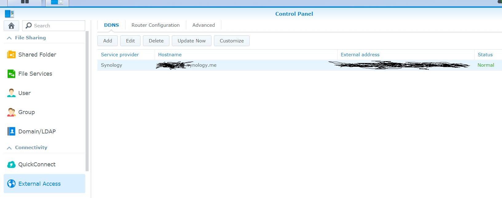

You can do it with the External Access feature of Synology DSM. See screenshot below : I use Synology Dynamic DNS service to have a fixed WAN IP address like MYHOSTNAME.synology.me. Then I use this Fixed WAN IP address to access Domoticz from outside (externally)

Hi safe would you rate this option?Antori91 wrote: Thursday 18 October 2018 9:35 You can do it with the External Access feature of Synology DSM. See screenshot below : I use Synology Dynamic DNS service to have a fixed WAN IP address like MYHOSTNAME.synology.me. Then I use this Fixed WAN IP address to access Domoticz from outside (externally)

From my experience (based at incoming connection log messages tracking), it is OK if you don't use usual standard Web port (locally you can use standard web port like 8084 but declare/use unusual port in your router NAT rule). With this simple rule, you don't see anymore weird connection coming from Russia or another countries.Jumper3126 wrote: Thursday 18 October 2018 14:33Hi safe would you rate this option?Antori91 wrote: Thursday 18 October 2018 9:35 You can do it with the External Access feature of Synology DSM. See screenshot below : I use Synology Dynamic DNS service to have a fixed WAN IP address like MYHOSTNAME.synology.me. Then I use this Fixed WAN IP address to access Domoticz from outside (externally)
