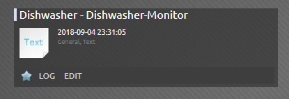

Ok, so what goes wrong is that I have 4 home-connect devices, of which one is the dishwasher (not the last) - see attached json. The function gethaID iterates over all the devices and uses the haId of the last device in the set.... Which is not the dishwasher in my case. I did a quick hack to make it select the dishwasher:
for data in homeappliance:
            items = homeappliance[data]
            for item in items:
                if item["type"] == "Dishwasher":
                    for key in item:
I suppose gethaId will need another argument that specifies the device type....
So, now I have the dishwasher as a device in Domoticz... but what's next... what is it supposed to do?

It doesn't log anything... so... What's next?

The only feature I've now implemented is Dishwasher-Monitor.
I think there is a small bug, namely <option label="Dishwasher" value="Dishwasher" default="true"/> must be <option label="Dishwasher" value="Dishwasher-Monitor" default="true"/>
If your dishwasher is running, you should see the status changing in domoticz.
I'm working on a version 2, which is using the onCommand methods of Baseplugin to get the Domoticz performance a little bit better, but I still have an error when I try to post some data tot de url. Does anyone have experience with this?
