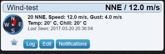

Right to the point:
It's a "dummy-sketch" to test communication between sensor node and Domoticz. With the following sketch Domoticz updates the values when i change wind speed and gust WITHIN the sketch manually. But i can change the number of the wind direction as much i want. Domoticz always uses 20 NNE. Why?

What am i doing wrong?
I am also wondering where the "Temp: 20C" come from...

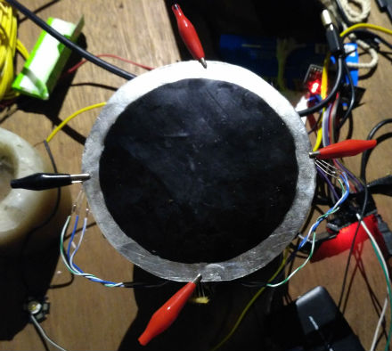

Purpose:
I am building a wind sensor without moving parts. With only 5 dallas tempeature sensors on a black metal plate i can calculate speed and direction. Everything still experimental and my programming skills are low. But tests without Domoticz show promising results.
I am sure somebody will see my mistake quickly :)

After some experimenting i found the source of the problem.
I gave the wind sensor a different NODE_ID in the sketch manually so Domoticz registers the sensor as a new node.
After that it seems to work.
For super noobs:
Add this to your sketch:
#define NODE_ID 3
