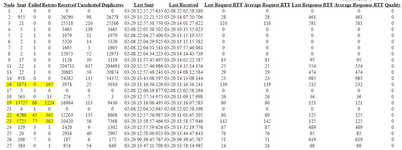

4 of the highlighted nodes in the attached screenshot are Fibaro Dimmer 2 modules.

What happens a lot is for example that when people go to the toilet, the light doesn't turn on immediately but after 5 seconds, and the log shows a timeout.
The topology shows all of these devices to be directly connected. Polling is disabled for all devices.
Looking at these statistics it shows that roughly 5-10% of all actions towards these dimmer modules result in a failure or retry.
My question is, is this normal for z-wave in general? Or are these Fibaro Dimmer 2 modules all of bad quality? Is it the thin walls? Can I do anything to improve this? I hope someone can shine more light on this.

I only see higher retries on 2 nodes where I have polling enabled. All other nodes have retries < 5.
