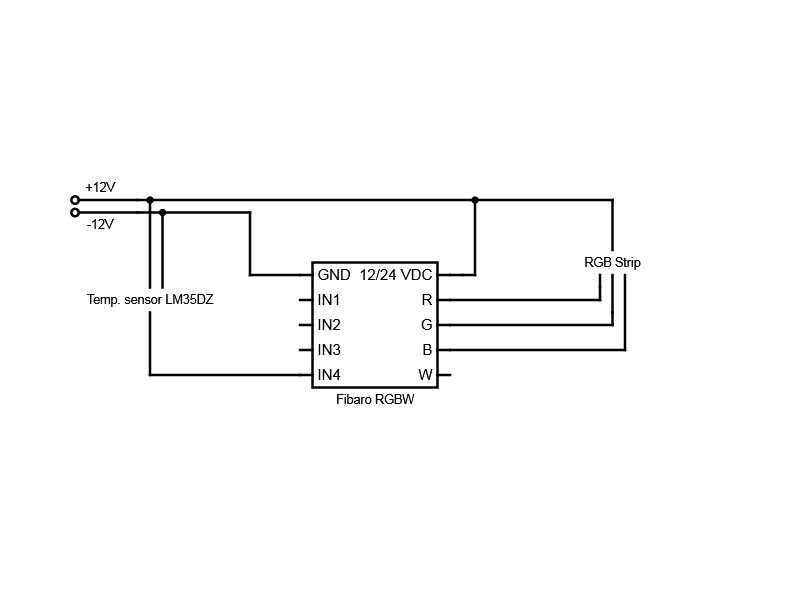

I have a Fibaro RGBW module that I connected to a RGB strip (note that there is no +W). I use a Raspberry Pi + Domoticz + Aeon Z-Wave Stick as a controller. Everything worked fine. Then I connected an analog temperature sensor LM35DZ that outputs 0-10V, so theoretically should work well with RGBW module. I attach a scheme of how I connected the modules.
Fibaro RGB Temp.png (9.81 KiB) Viewed 1195 times
RGB color-changing functionality still works, however I seemingly can't figure out how to read a temperature/voltage from the sensor. I understand that the trick is in properly defining a parameter 14. I tried a number of different versions of parameter 14 that I found on the Internet or deduced myself. I can't get anything to work, including 39320 which I think should be the correct one (1001-1001-1001-1000, all normal monostable out, in4 analog in).
I don't need any switches, I want to operate RGB through a Domoticz only. Is it possible to operate an RGB strip at the same time with analog 0-10V sensor? How should I connect and configure the node? What parameter 14 should be like?

following the fibaro logic... it could be that once you connect the temp sensor you have to exclude and re-include the device in the zWave Network
(for door sensors it works like that :( )
