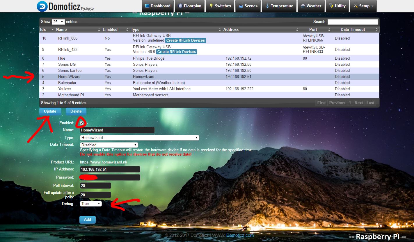

i try to get the plugin work, but wen i add it in hardware i can't enter IP adress or something else, because der are no fields.
In der log i get following.
2017-03-11 17:57:11.206 Error: (Homewizard) 'onStart' failed 'ValueError':'invalid literal for int() with base 10: '''.
2017-03-11 17:57:11.206 Error: (Homewizard) ----> Line 496 in /home/patrik/domoticz/plugins/domoticz-homewizard/plugin.py, function onStart
2017-03-11 17:57:11.206 Error: (Homewizard) ----> Line 59 in /home/patrik/domoticz/plugins/domoticz-homewizard/plugin.py, function onStart
Has anybody an idea

I solved it.
Tried it in chromium and the fields are there, everything works fine.
But my rollo shutter ist not in Device list
Greatings :-) Patrik

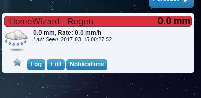

First of all, good job. I will be quiting Homewizard, but for the time being I will use Homewizard together with Domoticz.
I've installed your plugin within my Domoticz. And it seems to work in basic, I've notice two strange things so far. Maybe somebody can help me out?
- There showing up devices for Wind en Rainmeter, but I don't have 1 in my Homewizard.
- I've added my dimmer for the livingroom, if I change the state to on the light is going on, but after changing to another level the light is off
Thanks again for making this plugin!

remco770 wrote:First of all, good job. I will be quiting Homewizard, but for the time being I will use Homewizard together with Domoticz.
- There showing up device sfor Wind en Rainmeter, but I don't have 1 in my Homewizard.
Hi Remco,
Since I have stopped using my Homewizard a while ago I only have the usage for my Wattcher and the weather sensors so that is why you have the rain/wind meters by default ;) I started this plugin just for myself but decided to publish it for general usage since I am not alone with a Homewizard and Domoticz...
I will look into the dimmer issue, thanks for reporting that!

That explains why it's added by default. Can I just remove them from the devices tab? Maybe you could make a change in the code so that they wouldn't be added by default.
Also I did take a look at the log file, except from the errors where the wind / rainmeter isn't found. I've got the following other error:
2017-03-12 21:35:55.539 (Homewizard) Unhandled route received! (/sw)
I've noticed that the On/Off switch is not always working the first time.
If you need some debug information/log files, please let me know.

You can remove them but they will be added automatically again after a restart. I will look into only added them when found.
I know there is still a problem with the switches and working on it but thx for reporting it 8-)

Hi Wobbles,
I've setup my test environment on a RPI-3 and updated Domoticz to the latest Beta en your HomeWizard plugin to version 2.09
So far no stops but I get an error message from the plugin and my HomeWizard-rain device in domoticz is not updated.
Domoticz log:

Reply from HomeWizard on the get-status command in Chrome:

Hi Brogen67,
in separate terminal window do tail -f domoticz.log
in hardware:
. select HomeWizard;
. uncheck Enabled checkbox;
. click Update button;
. set the Debug choice to true;
. check Enabled checkbox;
brogen67
Posts: 17
Joined: Wednesday 01 March 2017 20:20
Re: Plugin - Homewizard
Post by brogen67 »
Hi Warren, thanks for reply. Ok, now I have same log as you ^^
