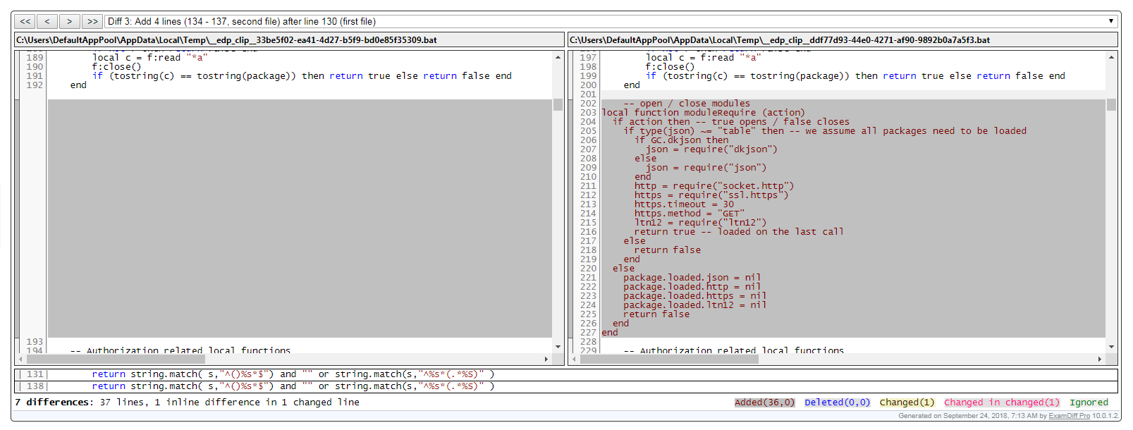

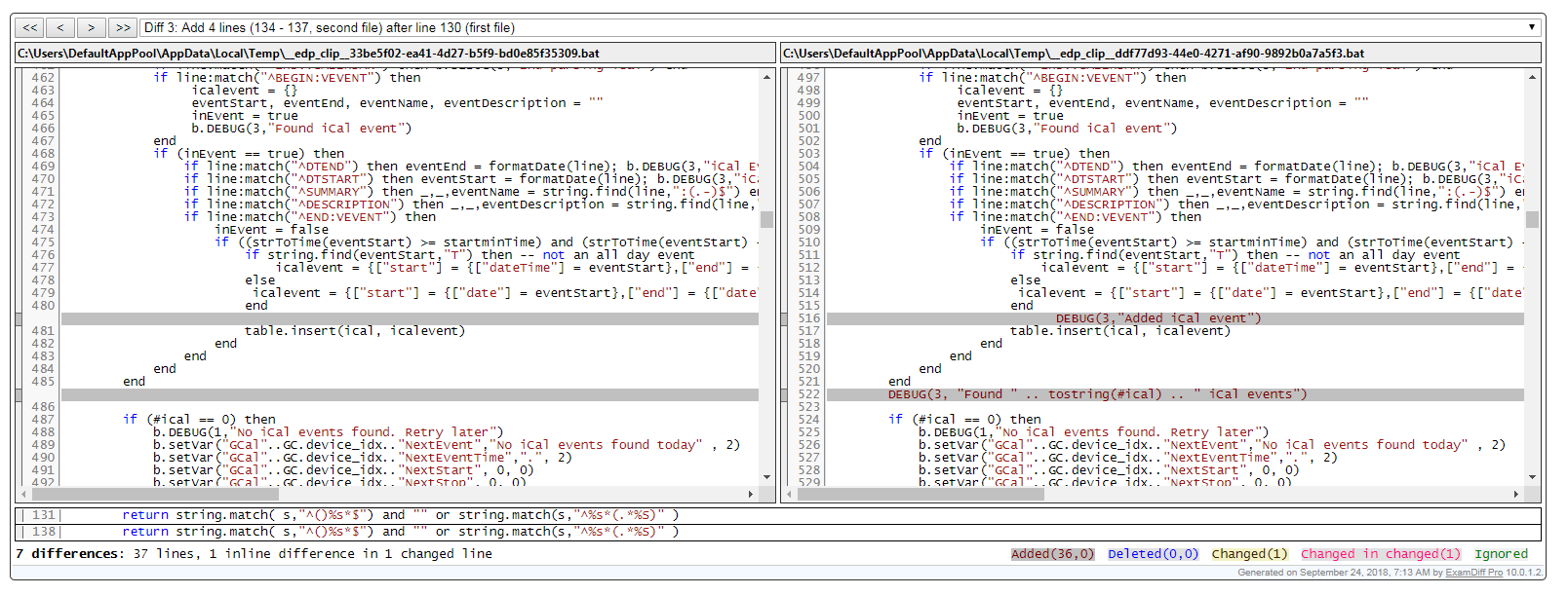

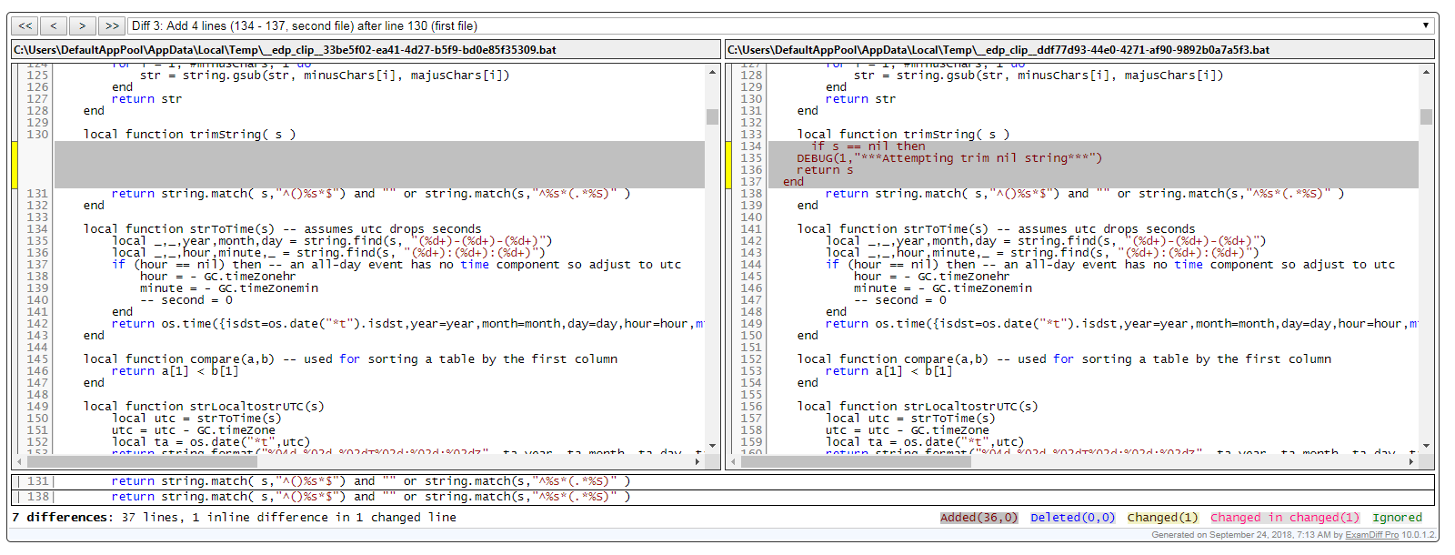

Edit:
I have now found out that we are not alone with the problem..
The original author of the script has a thread on this forum:
http://forum.micasaverde.com/index.php/ ... 2.690.html
And they have noticed the same, and "Stuart" have come up with a solution.
I have tried to check what the difference is between the files and tried to merge them to this project, but I gave up for now, will give it a little more time when I have more motivation. :)
TheeDude
Posts: 46
Joined: Wednesday 07 October 2015 0:43
Re: BakSeeDaa´s Google Calendar for Domoticz (deprecated)
Post by TheeDude »
Hello again, or am I just talking to myself? :)
I did try it out yesterday, but failed.
I got a couple of fail messages that I had to resolve, but now when I initiate the switch, nothing happens, not a word in the log, nothing.
I have tried to compare both Stuarts files, and the latest gcal3 file from BakSeeDaa and tried to merge them together, but as I said before, lua/scripting isn´t really my strong side.
Anyone else that can check it out or help me/us in the right direction?
Here are the files!

script_device_gcal 1.0.3.rar
(14.31 KiB) Downloaded 120 times

Thanks for your help! I tried your file but it does not work for me. What did you change in that file?
TheeDude
Posts: 46
Post by TheeDude »
jasifil wrote: Monday 24 September 2018 14:52 Hi!
That´s too bad!
You can use "https://www.diffnow.com/" and compare both new and old file in that and see the differencies.
But I can add them here as well.
What does the log say?
