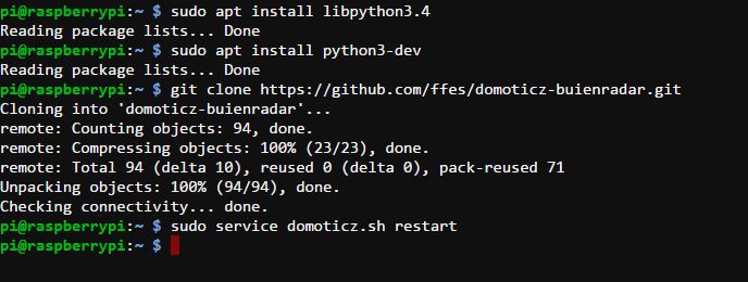

Re: Buienradar Weather Lookup Plugin
After following install instructions there is no new hardware. Do I have to do something extra to allow plugins ?
- install buienradar.JPG (46.93 KiB) Viewed 3335 times

The git clone needs to be done in the your domoticz/plugins subdirectory. So before the git clone command type "cd domoticz/plugins"
Sorry, I did the original install in the plugins directory.
The picture was to show the commands I entered
Edit : when I run localtest.py there is an error :
File "localtest.py", line 13, in <module>
from buienradar import Buienradar
File "/home/pi/domoticz/plugins/buienradar/buienradar.py", line 16, in <module>
import urllib.request
ImportError: No module named request

Installing the code is not enough - you know you have to add the Hardware part in Domoticz?
That is the problem, i don't see any new hardware.
When I try to install the request module, it says there is allready such a module (in python 2.7)
In usr/lib there are 4 python maps (python2.6, python2.7 , python3 and python 3.4)
Should I remove the two lowest versions) ?

If you select Hardware in Domoticz - click on Type selector - Buienradar.nl (Weather Lookup) is not present ?
I would not bother about localtest.py - it is not used in active plugin ... it has to be fixed though

Same for me, buienradar does not show up in the Add HW list
Henk50
- Posts: 7
- Joined: Saturday 18 February 2017 9:34
Are you running the beta version? That's necessary.
Have you done the following steps (Raspberry Pi)?
sudo apt-get update
sudo apt-get upgrade
sudo apt install python3.4
sudo apt install libpython3.4
sudo apt install python3-dev
Whats in the Domoticz log?
Running stable here.
sudo apt-get update
