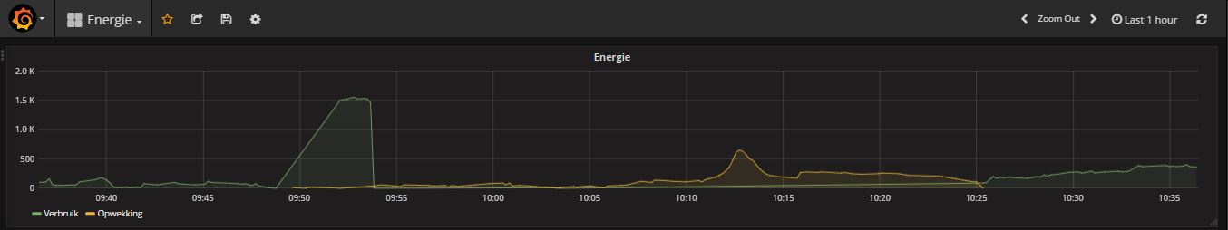

Excellent option, now I can see my data in Grafana finally.
Something that did not work when using http-link.
I guess because of the timestamp... in '1970-01-01T00:24:47.358933Z' that problem is now over when using this option. :D

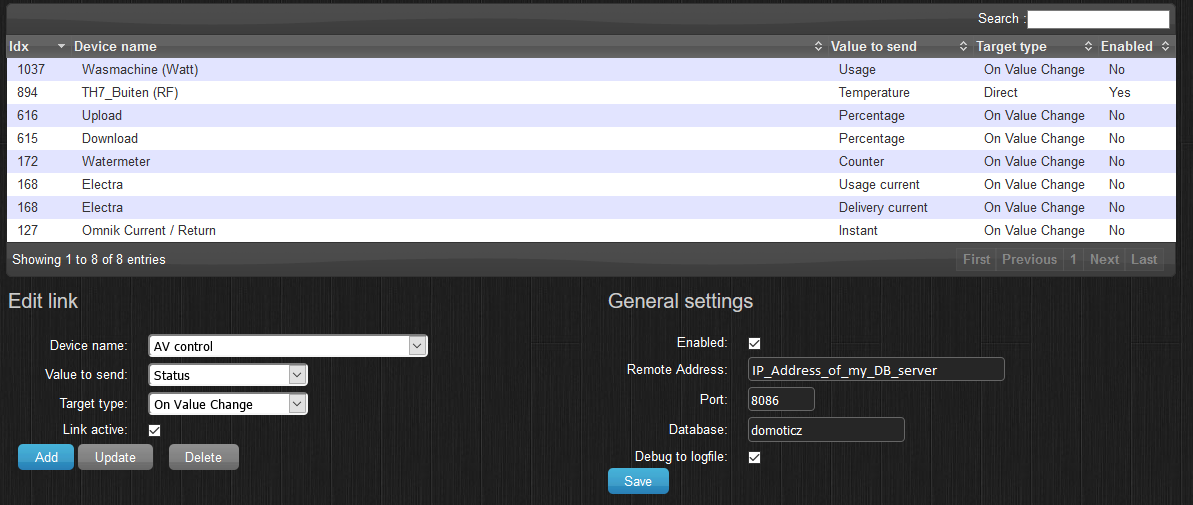

sincze
Posts: 1302
Domoticz version: 2024.4
Re: Data push ---> InfluxDB
Post by sincze »
Please find attached my settings:
Database was created in influx with:
CREATE DATABASE domoticz
if I remember correctly. :D

dolby44
Joined: Wednesday 15 June 2016 15:36
Post by dolby44 »
If you have put a password to yout database (what I recommand)
In database field, put:
domoticz&u=DatabaseUser&p=DatabasePassword
and it works !

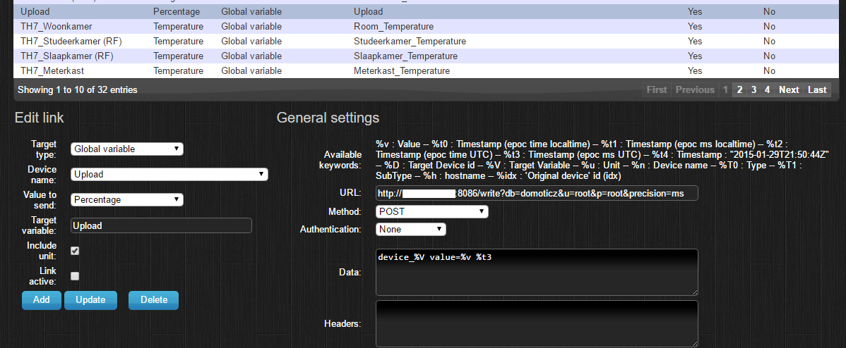

sincze
Posts: 1302
Post by sincze »
Just to be sure. were you using HTTP link or INFLUXDB under DATAPUSH menu??
http://influxmachine:8086/write?db=domoticz&u=root&p=root&precision=ms
These are my settings.

sincze
Posts: 1302
Post by sincze »
mmm that one worked for me. can you switch for a test to httplink and add the line a shown in my earlier post??
I MOVED away from both http link and influxdb from within domoticz as I received error messages like 'to many open files'.... causing domoticz to lock up. Had to solve it in a different way. (Pass2Php with custom influxdb function). Has been running fine since then :D

sincze, httplink is pushing, no errors in log, but I can't figure out how to get remotely similar data in the httplink config or any values. Most of the wiki and older posts seems to be from old version of InfluxDB,
General settings as you suggested adjusted for my ip.
Data:
device_%V value=%v %t1 %n %D Tried lots of variants...including what you sent. Syntax is unclear to me with commas, spaces, etc varying widely in examples I'm finding on posts
active and debug checked
Edit Link:
Target Type: Global variable (errors when I try Virtual Device)
Device name from popup for items.
Value to sent: no choice here
Target Variable: No idea what goes here, generic terms like "temp"
Include link checked
Link active checked
I'm not getting any values in Influx that I can pick out with queries
I think I'm probably going to have to give up on this unless the InfluxDB option gets fixed...too much time wasted on this in last several days. So close with that, just broken timestamps I can't fix.
Tim

mm this should work.
