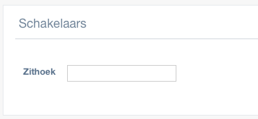

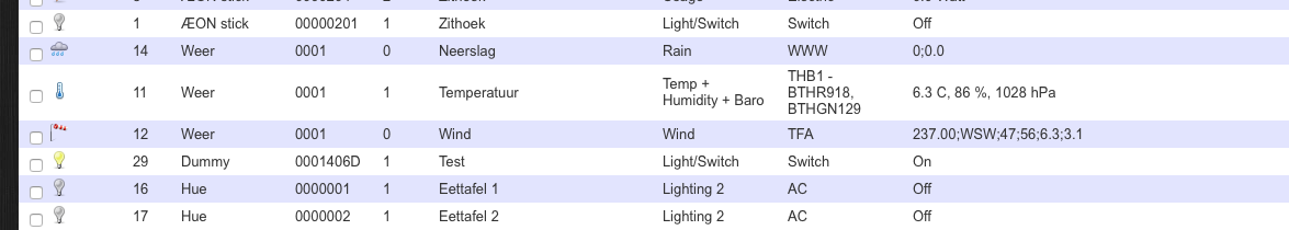

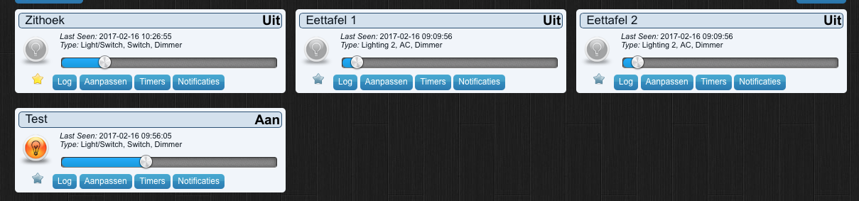

Hello!
I really love the domoboard! Been playing with it for a while now. Everything works fine, but there is one thing that I can't fix. I have three dimmers (two Hue lamps and a Fibaro dimmer 2). In domoticz they are shown as dimmers with a slider.
Schermafbeelding 2017-02-16 om 10.27.45.png (105.65 KiB) Viewed 2324 times
When I add them to the domoboard the Hue lamps (IDX 16/17) do work, but the Fibaro dimmer (IDX 1) doesn't. I get an empty square. When I add the dimmer as switch it does work (only on/off, no dimming).
Schermafbeelding 2017-02-16 om 10.27.31.png (8.53 KiB) Viewed 2324 times
I saw in the devices table of domoticz that the subtype of the Hue lamps is AC and light/switch for the Fibaro dimmer. I thought that that could be an issue. So I added a dummy switch and set the type to dimmer (IDX 29). Then I've added the dummy dimmer to domoboard and guess what: a slider :shock:
Schermafbeelding 2017-02-16 om 10.28.15.png (48.96 KiB) Viewed 2324 times
Does anyone have an idea of how I can get the Fibaro dimmer in domoboard?

ztorm wrote:Hello!
Hi ztorm,
Hmm that's an unusual behaviour. did you get an error in you're console.log when domoboard tries to init an dimmer on zithoek?
It looks like it should work but if there are no errors its a little bit difficult to debug it :)
