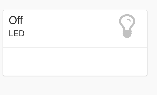

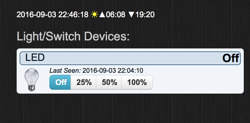

Selector style switch is not supported?

Not yet, will look into this asap!
