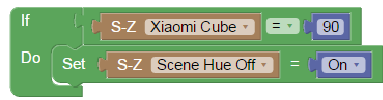

Hi everyone,
I would like to know what combinaison of blocky i have to set for xiaomi cube :
- Shake
- 90°
- 180°
- move foward
Xiaomi Cube + light

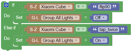

@DreaMare
You are almost there, just change the value 90 to "flip90" (it's another user value box).
