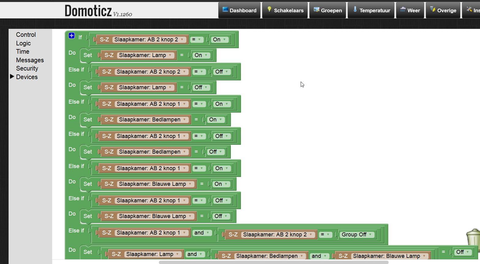

DennisB
- Posts: 1
- Joined: Friday 18 October 2013 17:45
Re: Blockly examples
My first created blocky scenario of last week (just after I got Domoticz running on my Raspberry), a regular routine test to check the flexibility of the Domoticz system. I must admit that I never got a positive result that quick.
The use case is to switch on a few lights at 6:00 on workdays and leave then on until 30 minutes after sun-rise. But off course the "on event' should not be activated if the sun is already up.
I solved this with one blocky event and a normal ''after sun-rise" event. The only issue I have with blocky is that I could perform a for a "sun-rise" check, but not for a "30 minute after sun-rise" check.
- blocky_1.jpg (22.08 KiB) Viewed 27740 times

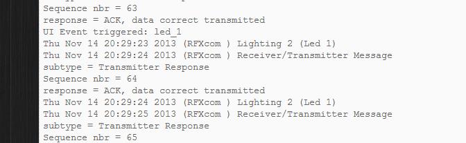

Derik
- Posts: 1605
- Domoticz version: BETA
A problem, for me..
Juist work with the latest beta. An it is not working.
edit: 8-11-2013
Please.
Has anyone might be time to help me.
This setup does not work.
I think I'm really wrong.
but this simple scene, I am not get it working
I search and try also a scene where I send a off signal between certain times every x minutes.
I am looking me crazy, but he does not ...
Edit log.
A problem, for me..
edit: 8-11-2013
Please.
Edit log.

Could someone help me. Please
I would like to send a off signal to a lightswitch between sunrise and sunset.
And then make this one every x minutes.
I do not get it ...
And I've been working on tougher events ..
I do not get it ...

- CopyCatz
- Developer
- Posts: 123
- Joined: Thursday 11 July 2013 17:28
- Target OS: -
- Location: Outer Heaven
It's way simpler to set this in a schedule at the device itself. I do this every hour during the night. Your example is confusing, you would want to start with if time > sunset & time < sunrise, then switch off everything that is supposed to be off. But this will then run every minute. Running every hour or so is better for the rf traffic, and that you can do in a device schedule or lua script where you could determine elapsed time (can't do that in blockly).

Hello, i made this blockly event, but it's not working between the timetable, it's working each time of the day i'll open the door!
Can somebody tell me what i'm doing wrong?
Time in Domoticz is ok
latest update 1341
greetings
latest update 1341
greetings
