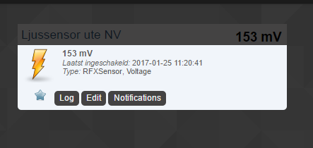

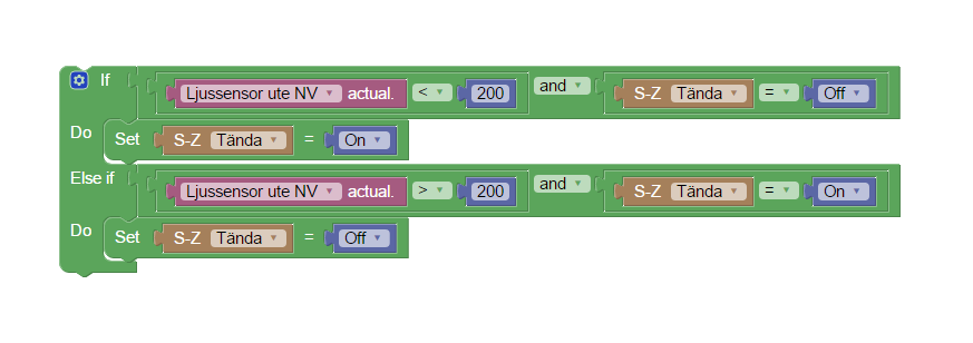

I have a problem with my lightsensor and blockly. Can you please help me and see if I've done something wrong?
I have a "lightsensor" on 1-wire. It is a sensor that reports a voltage depending on the light. I want to use this sensor (Ljussensor Ute NV) to turn a dummy switch (Tända) on and off depending on the voltage. On a value below 200 I want it to be on, and over 200 I want it to be off. I'm going to have som more parameters in it later aswell, but for now I just want this simple thing to work. I have made a blockly like in the picture, but it wont work. When the value is above 200 there is no problem, the switch is off. But when the value drops below 200 it keeps going on and off at the same time. Have I done something wrong?
Maby a simple mistake by me, or is it something wrong in domoticz? I'm currently running v3.6595 built from source.
Any ideas?

I cant see anythin g wrong. But try to set it up like this so you do not have the same number for on and off:
You can also try 199 if thats better.

Possible 2 reasons for the frequent switching.
1) Why did you include Tända=Off respectively Tända=Off in the IF-statements?
2) Checking in both Blockies just at the 200-level may cause a frequent switching, due to a dynamically fluctuating light-input.
Possibly around the '200'-level your 2 Blockies interact due to switching delays interfering with the check in the IF-lines.
Probably you intend to check whether it is necessary to switch, but the 'rude' method also works, of simply ordering a switch without check beforehand.
As improvement for 1) suggest to try in the first Blocky the simpler IF-statement
IF Ljussensor ute NV < 200
And in the second Blocky
IF Ljussensor ute NV > 200
To solve the dynamic aspect under 2) you can somewhat 'smooth' the new check by including a hysteresis like:
IF Ljussensor ute NV < 190
IF Ljussensor ute NV > 210
The practical thresholdvalues have to be found emperically.

1) I like to have the Tända Off/On in the IF-statements for the blocky to check if it need to turn it on or off. But It's absolutley not needed for the function. I removed it for now just to get the main funcion of turning on and off to work.
2) It will absolutley cause frequent switching when the value in around 200, because it fluctuates. But the thing is that it keep turning on and off all the time even when the value have dropped. Like now for example the value is 56, but still keeps turning off and then on again.
I tried your examples, but unfortunatley it doesn't make any difference
. Maby it just is some kind of a bug?
Thanks a lot for trying to help though!!

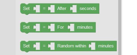

What happens if you include a time-delay in the switching for a lightlevel < 200, by means of the middel block shown below?
It is a 'cosmetic' treatment, but with such delay you can suppress undue switching due to fluctuations of the light-input.
Sometimes it helps to apply a separate, auxiliary signal (a socalled 'semaphore' or 'flag'), instead of directly taking the result of the IF-statement using the signal-input. Reason: you clearly separate into slow and fast loops to avoid undesired, dynamic interaction, and the real switching is only performed at the conclusion of the decision process.
You have a flagman, which after his own looking & thinking, by flagging generally guides the traffic (= your dimmer) ......
Possible (simplest) example layout for your case applying Blocky-components, incl. help of a delay:
IF level <200, DO "Flag = True for 5 minutes"
IF Flag = true, DO Dimmer = ON

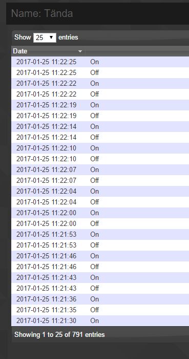

One thing that puzzles me when viewing your switch history listing, is the fact that both the ON and OFF transitions occur at the very same second. That "should" be impossible, according to the logic you have defined.
The script will only run once per second, and when the first 'If' expression evaluates as TRUE, it should never even attempt to evaluate the 'Else if' during the same excution cycle. Consequently, it would be practically impossible for the script to take both of the actions at the exact same time.
You wouldn't happen to have another (similar) copy of that script activated simultaneously? When testing new stuff myself, I often save multiple versions of my work, so it wouldn't be a situation totally unheard of...
