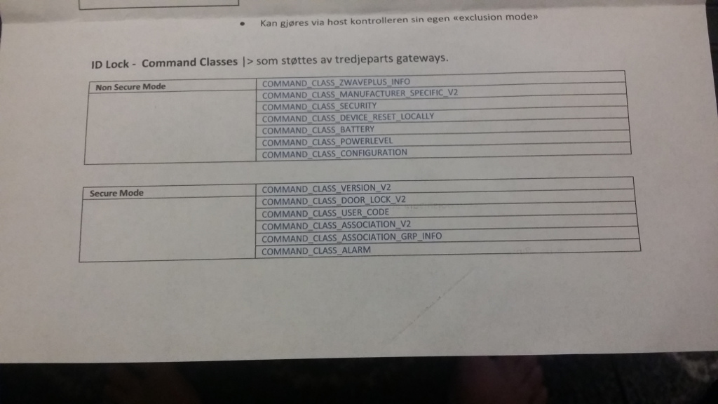

I received the unit just before Christmas.
I have attached a photo of the information that was included with the module.
I havent succeded yet!

cogliostrio
- Posts: 77
- Joined: Sunday 06 September 2015 11:58
Re: id locks
I took the file you attached, of the ozw generated settings, and made it into a settings file.
add this to your manufacturer_specific.xml
Locate where the config files are on your Rpi, create a folder called idlock, and put the idlock.xml file in it.
stop domoticz, delete your zwcfg_xxxxxxxxxx.xml and restart domoticz.
The picture you posted shows the command classes that idlock support. What you need to get a hold of now is the settings for each command class to complete the settings for the lock.
