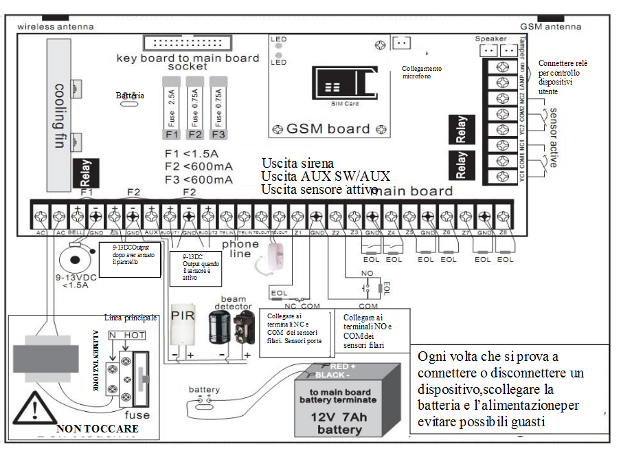

The central allarm is this in picture and teh contact is csollegate in Z1 to Z7 input whit a resistor in serial to the NC contact.

So I think your original idea could work, but it would not look good. You would have to have some sensor in front of the leds on your alarm panel.
I can't read your diagram, but if there are outputs available that change state when the alarm is armed, and when the alarm is activated, you can use those. You may have to change the levels to feed into a pi. For instance, I would think you can tap into the bell output, which is probably 12VDC. You would need to convert 12VDC to 3.3VDC before connecting to the pi IO pins.

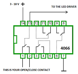

If you're somewhat familiar with electronics and soldering (and not worrying about waiving your equipment warranty), I suggest you trace the circuitry from the led all the way back to its driver chip. Most likely there are some components (like a resistor and/or possibly a diode) in between the led and driver chip output pin, but you will surely find it.
The driver chip output feeding the led should be more than enough to also drive a simple CMOS latch, e.g. a 4016 or 4066 chip. Then you will have a simple, cheap and absolutely reliable "dry contact" that opens and closes depending on the led status. Use the same DC power that supplies the led driver chip to also supply the added CMOS chip. Below you will find a small illustration on how to wire up such a CMOS circuit. And please note that there are 3 more latches available inside that chip, so with some additional wiring you could use it for monitoring a total of four different led's if you want.
Anyway, that's the nice and clean way I solved the same problem. I certainly didn't want to attach anything on the outside of my old alarm box, just to monitor the led indicator status!

Thanks for the answers. Besides I would like to monitor the logging EStore been armed or disarmed alarm, in a txt file also the state of each sensor while the alarm is armed. For example, with armed alarm is activated, the sensors have a log that are clicked.
For me there are no problems using IC 4066, I am an electronic profession.
I would like to use Raspberry Pi GPIO connector and not an Arduino sensor.
