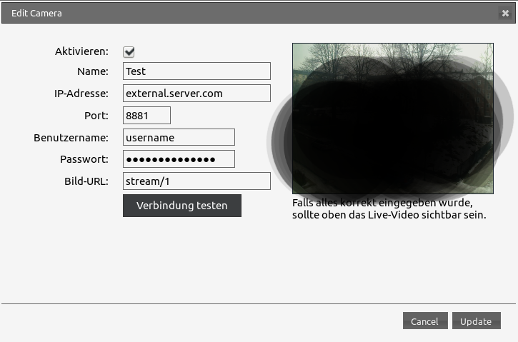

Just had a look at this problem again.
So I picked one particular camera, a USB device which is accessible in browser with the following URL from the internet:
https://username:[email protected]:8881/stream/1
and with (both http or https):
http://username:[email protected]:8080/stream/1
from internal network.
And I can see the preview with both variants:
I inspected the elements with firefox's built-in inspector and for the preview I get this:
<img id="camfeed" onload="load_testcam_video()" src="http://username:[email protected]:8881/stream/1?count=258" style="max-height: 220px; border: 1px solid #1E2832;" width="280" height="210">
which has the working URL and port as src and works
and for the stream I get the following:
<img id="camfeed" name="camfeed" onload="load_cam_video()" src="https://external.server.com:8443/camsnapshot.jpg?idx=1&count=2?t=1486563611119" style="border: 1px solid rgb(30, 40, 50); width: 599px; height: 338px;" width="600" height="337">
which has the URL and port of my domoticz-server and a "camsnapshot.jpg" suffix which is presumable generated by domoticz itself and doesn't work.
It doesn't matter if I use the internal IP and test from internal net or use the external servername and test from outside.
So somehow the assembled "camsnapshot.jpg" is wrong. Why can't we just use the user-given URL to view the stream instead of trying to generate a new URL which seems not to work with a bunch of webcams?
