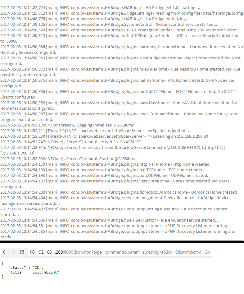

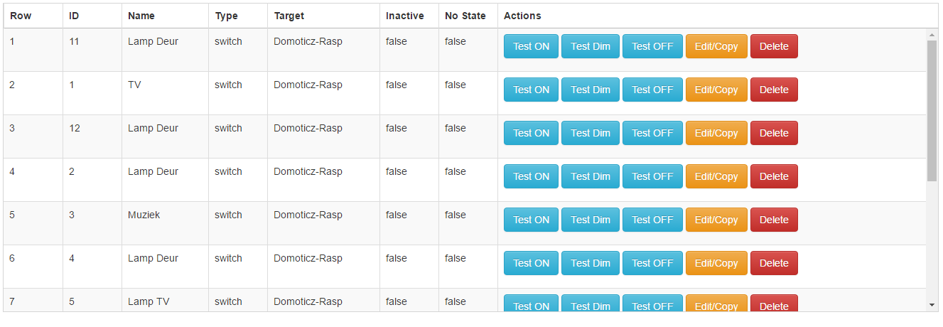

So far, so good. I see my Domoticz-devices in the bridge and I can control them using the test-buttons within the HA-bridge. Also I'm able to control my smart home devices via the browser. But when I ask Alexa to discover any devices she isn't able to find the smart home devices. I've tried the following:

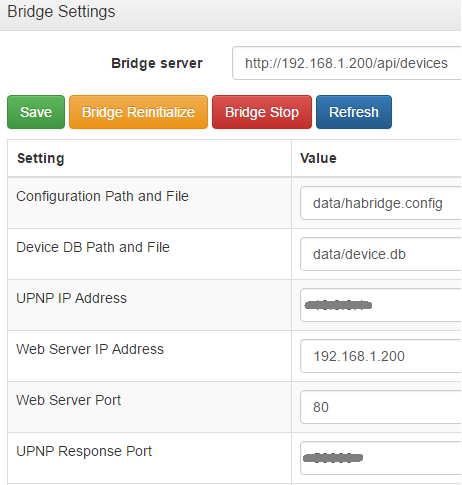

- Changing the port of the HA-bridge to '80' instead of '230' (8080 is taken by Domoticz)

- log.png (118.93 KiB) Viewed 847 times
- BridgeSettings.png (22.97 KiB) Viewed 847 times
- Devices.png (62.66 KiB) Viewed 847 times
