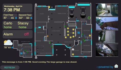

Hi guys. I am a complete newbie in matters related to Rasprberry Pi and Domoticz, but I already bought RPi 3b + and installed Domoticz on it. I plan to create a smart home control system. As a control panel I plan to use the original RPi screen. Among other things, I want to implement a video door system in the door: to see on the screen who is ringing the door. Is it possible to implement this in Domoticz? Could you sugest how? Unfortunately I can not find a suitable camera for these purposes. Tell me, is this suitable: https://ru.aliexpress.com/item/32903314 ... 2e0e7sqMUH
Thank you in advance.

as I said earlier, I understand little about this, so I want to clarify: what will give me the opportunity to receive screenshots that the camera sends to FTP? I have a task to get streaming video on the RPi screen when someone rings my doorbell. until I plan to send myself notifications to the phone via telegram
for example pic attached
