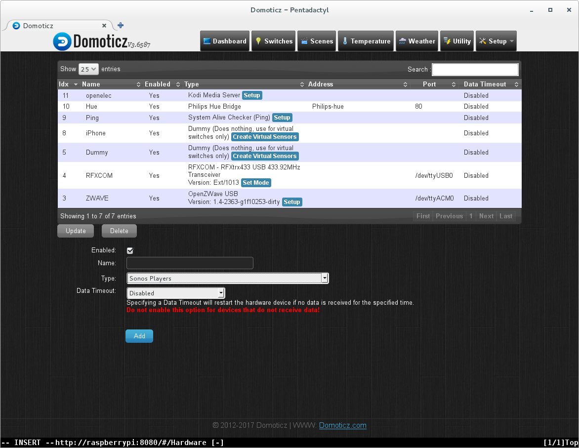

I wrote a python plugin for Yamaha AV receivers, you can find it on github:
https://github.com/thomas-villagers/domoticz-yamaha
This is very similar in structure to the Denon Plugin in the examples folder, but much simpler though.
I think the plugin system is really nice and useful, but - I know it's still beta - there are some difficulties:
- debugging python plugins is somewhat tedious; after code changes, the plugin has to be deactivated/activated in the hardware pane from the web interface. Or is there a faster way to do that?
- a built-in connection timeout event would be very nice
- it's easy to crash domoticz completely (seg fault) simply by deactivating the plugin; at least that's what's happening with my plugin in case a connection is established. I don't know why this happens, it is probably my fault, but I can't see what's wrong with it.
- the Debian browser iceweasel doesn't render the parameters defined in a plugin's xml definition; see attached screenshot (Sonos Plugin, the Address, Port and Debug fields are missing)
And ah, yes: what's the state of the remote control button in the Media Player switch ?
It works with the native Kodi plugin, but not with the python plugin system - clicking the remote control button has no effect.
Thank you!
thomas

@thomasvillagers,
I had a look at the code and it looks really good, I can't see anything that should cause any issues.
My I only feedback is that I have tried to stay away from updating Domoticz devices in onCommand and try to do it in onMessage whereever possible. This is because in onCommand you are requesting the external device to do something but onMessage tells you what it actually did. In some of your code you seem to do it in both places.
I see you used a polling array (which I only thought of recently and think is a great idea) to help keep things in sync which works well for me.
To answer your questions:
). This is occasional on my Windows machine and Ubuntu VM but seems much worse on my Raspberry Pi. I have found a few issues and resolved them but there is at least one more, it happens during the release of the Python interpreter when ALL allocated memory is being freed. If Python isn't 100% happy it will abort. Good news is that running plugins seem very stable on all platforms. In the short term I would recommend doing Python dev on a Windows PC while I try and find it.
You can select the hardware in the table and hit 'Update' once (unless you have changed the XML that describes the user interface, then you must restart Domoticz)- debugging python plugins is somewhat tedious; after code changes, the plugin has to be deactivated/activated in the hardware pane from the web interface. Or is there a faster way to do that?
I'm happy to add functions if they are useful. I would have thought you could do a timeout already though. The plugin knows when it connects and when messages arrive and are called on the heartneat regularly so you can track total conection and inactivity pretty easily and force a disconnect if required.a built-in connection timeout event would be very nice
There is an issue sometimes when deactivitating plugins, not your fault (its mine I guessit's easy to crash domoticz completely (seg fault) simply by deactivating the plugin; at least that's what's happening with my plugin in case a connection is established. I don't know why this happens, it is probably my fault, but I can't see what's wrong with it.
Surprised about IceWeasel having issues because I tested Chrone, IE but did most development on FireFox. Can you bring up the debugger window and see if there are any javascript errors?the Debian browser iceweasel doesn't render the parameters defined in a plugin's xml definition; see attached screenshot (Sonos Plugin, the Address, Port and Debug fields are missing)

Hi Dnpwwo,
thanks for your reply and clarifying a few things.
I'll move the device updates to onMessage as soon as I can find some time.
And I just checked, the issue with iceweasel seems to be fixed now, great!
- thomas
