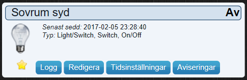

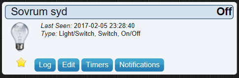

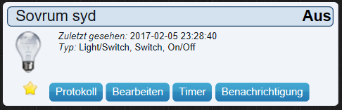

A few screenshots of various languages below:
