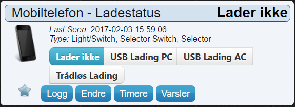

I have this multistate device for changing state on my mobile phone:
Uten navn.png (30.5 KiB) Viewed 592 times
I want to do this:
If multistate device CHANGES TO (from other state) "Lader ikke" and if som other devices is off
do: dim 3 lights to 10%
how can i do this?
I only want it to trigger if the multistate device changes to "lader ikke", not if it IS "lader ikke" and some of the other switches change status.

Store the changed status to some user variable for example and compare also to that 8-)
pseudo code:
if yourswitch.status = wantedstatus and yourswitch.status <> laststatus then
 do the stuff... set dimmer.
end if
set laststatus = yourswitch.status
