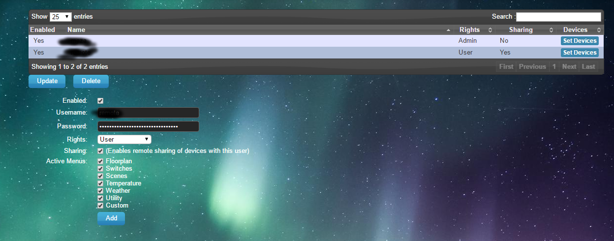

you can do it and it is very easy. The A computer should be the master and all the others slaves. Than means that you can send updates from B & C -> A and on the other hand you can send commands from A to B & C.
To do this scenario, you just need to add on B & C a new hardware and select "Domoticz -Remote Server". You will need to enter the ip of A on the field as also user/pass of domoticz on A of the user that can perform device sharing.
Also you can configure which devices will be shared from slave nodes (b,C) to A.
A minor problem is if you like to update a sensor from C -> B, or B-> C but as you said it is not required for now.
Hope it helped.
Hope it helped.
- master-slave.png (389.41 KiB) Viewed 955 times
- salve-configure.png (286.57 KiB) Viewed 955 times
