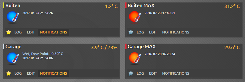

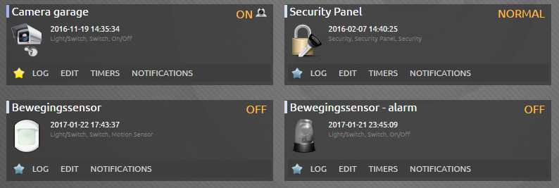

Thanks for your messages! Good to see you like this theme :D
The devices are also showing some more information in the small colored bar at the top left (standard Domoticz functionality).
White -> normal
Blue -> protected device
Red -> not updated for a while
Yellow -> battery almost empty
The bars are small but usefull :mrgreen:
See the examples below.
buttons 2.png (122.16 KiB) Viewed 6359 times
