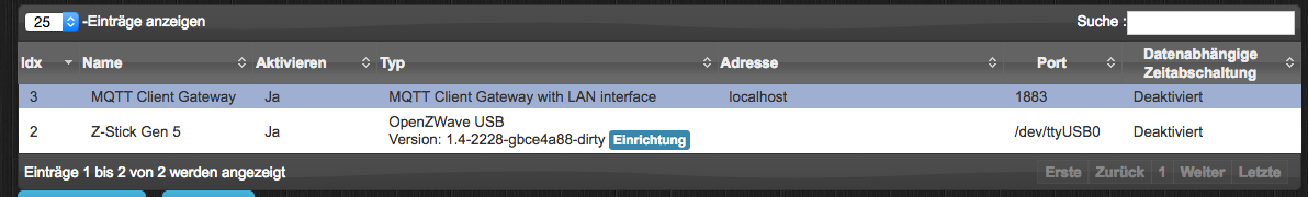

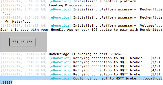

Posts: 10
Joined: Sunday 29 January 2017 8:22
Re: homebridge-edomoticz Plugin
Post by drmabuse71 »
first of all: thanks for the great help given on this side !!! :)
Has someone solved darrepac´s problem ?
Got the same:
[1/29/2017, 8:14:41 AM] [eDomoticz] Could not connect to MQTT broker! (localhost:1883)
the Devices are shown in HomeKit, but they don´t work.
I checked it out with only one device, an Aeotec Switch DSC24 - 2nd generation.
The switch itself is shown in HomeKit as a switch, but does not work.
The two meters, Voltage and kWH are shown in Homekit as "not supported devices" - they are unlighted.

drmabuse71
Posts: 10
Got some news:
I figured out, that the switch works, if I turn off my MQTT Device in Domoticz !
Homebridge says something as: Turn on your MQTT Dummy in Domoticz or something,
but the device is working :-(
Seems, that there is something wrong according the communication between Domoticz and the
homebridge Plugin .....
Any solutions ?
Kind regars, Michael

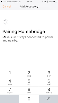

Post by EdddieN »
I can see my hombebridge:
but stays there forever to eventually fail. My terminal windows says all ok, running on port 51826... any idea

I tried that one too, nothing...

Right I got it to work if I run from terminal "homebridge", however if I use the instructions at boot up on post #1 of this thread I get this when running status:
● homebridge.service - HomeBridge Service
   Loaded: loaded (/lib/systemd/system/homebridge.service; enabled)
   Active: failed (Result: exit-code) since Mon 2017-02-06 18:53:25 GMT; 2s ago
  Process: 2060 ExecStart=/usr/bin/homebridge (code=exited, status=203/EXEC)
 Main PID: 2060 (code=exited, status=203/EXEC)
Feb 06 18:53:25 pi systemd[1]: Started HomeBridge Service.
Feb 06 18:53:25 pi systemd[1]: homebridge.service: main process exited, code=exited, status=203/EXEC
Feb 06 18:53:25 pi systemd[1]: Unit homebridge.service entered failed state.
any ideas, this linux is really new for me

Right, finally got it working. Not sure what I was doing but a mix of un-installing as much as I could, installing as post 1 and then using the Wheezy option to start at boot.
