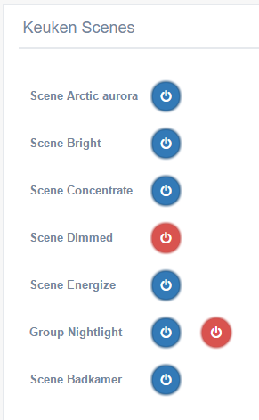

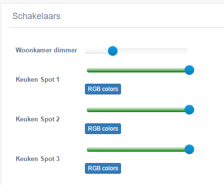

Here are an couple of pictures with the new features in it :)

and the scenes and dimmer adjustments are new in the master branch.
The adjustments on the dimmers are that you can click on the label of the dimmer to switch him on and off and if the dimmer is on the slider will be green.

Jep there in the example config. for the setpoint slider you need the following config:
therm = 71, setpoint_slider, 16, 26
16 is the minimum value of the slider and 26 the maximum so you can set this on anything you want.
For the dimmer config you need the config:
dimmer = 123, dimmer
thisone can also be found in the example.conf

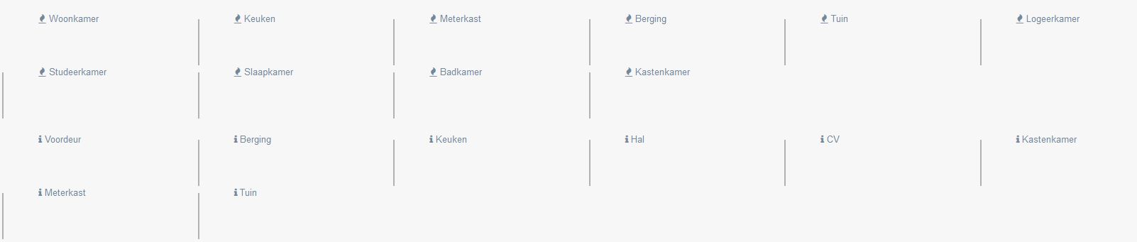

Have some different issues now that I will have to fix later. Need to study the new example.conf for latest changes.
Currently dashboard looks like this.

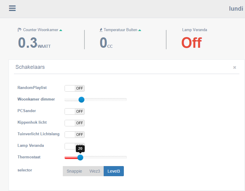

Really nice, thanks, I was so happy about that, that I haven't opened up the example.
One think that I've noticed is that if I use the dimmer (also setpoint_slider) on a computer browser when I put the mouse on the circle I can see the actual value or the value I'm going to choose.
On a tablet or smartphone I cannot do it. Is there a way to have that value always visible? I know that probably is not the best thing to see, but I don't see any other way to see the actual or changing value when on a device like that.

Just updated and loving the new dimmer and setpoint changes! :D
The top tile text spacing is sooo much better now too, WELL DONE!
Is there some example code for the selector switches? It'll probably obvious when I see it... but, well it's monday ;)
nothing as simple as just the selector switch idx DOH! :oops: :oops: :oops:

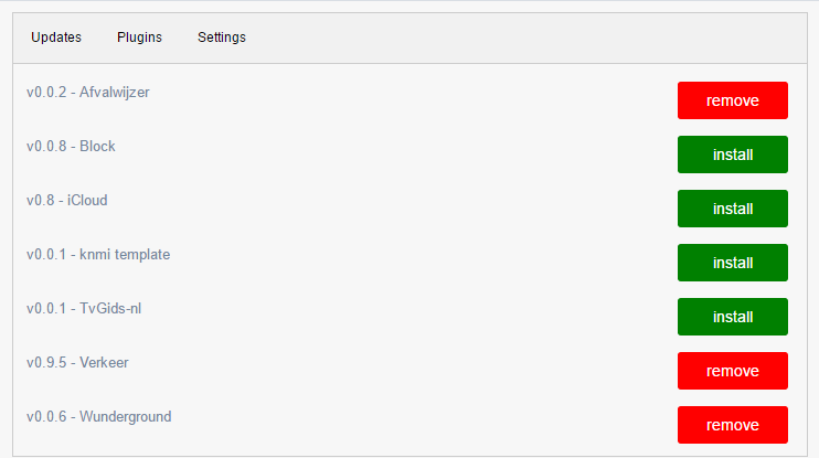

Thanks for the new version(s) of Domoboard.
I saw that top_tiles are sorted the correct way. Within the sections too.
Also that you can choose which plugins you want to install.
Great work.
