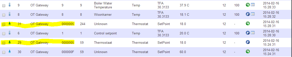

Everytime i restart my pc running Domoticz with the OTGW attached, some devices are added again.
For example the thermostat setpoint is added again, so it is listed twice after a restart. The old device isnt updated anymore. Does anyone recognize this or has a solution?

CodeItAway
Posts: 27
Joined: Tuesday 11 February 2014 21:44
Re: opentherm gateway
Post by CodeItAway »
Strange. I am running 1.1485 on Windows 7. The opentherm gateway is connected via a com port.
This is a screenshot after a restart of domoticz:
gizmocuz
Posts: 2706
Location: Top of the world
Post by gizmocuz »
Just restarted domoticz... i keep the same...
Anyone else have this problem (or not ;)?

I had this issue 2 weeks ago... But I didn't happen again.

I think i have found the problem.
In OTGWBase.cpp, function UpdateSetPointSensor, the value of dunit on the _tThermostat struct is not set. This value is used for adding/updating the devicestatus.
I'm setting up my pc to compile domoticz to confirm.

@gizmo,
After the last update I've got the issue again (with the opentherm devices)
gizmocuz
Posts: 2706
Post by gizmocuz »
?? bump.... the dunit is still set.... nothing changed....
CodeItAway
Posts: 27
gizmocuz wrote:?? bump.... the dunit is still set.... nothing changed....
Maybe the dunit value was not set to zero prior to the latest fix. Now it is fixed at zero, but it was nonreferenced, so possibly another (static 'random') value.
