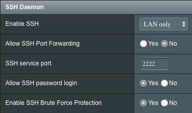

  3. start the SSH daemon on your router by logging into it and then going to "Administration" --> "System" --> adapt the settings according to the image:
    Screen Shot 2017-01-18 at 13.36.12.jpg (19.87 KiB) Viewed 14195 times
    You can also choose another port, it doesn't matter, you just have to remember it for the next steps.

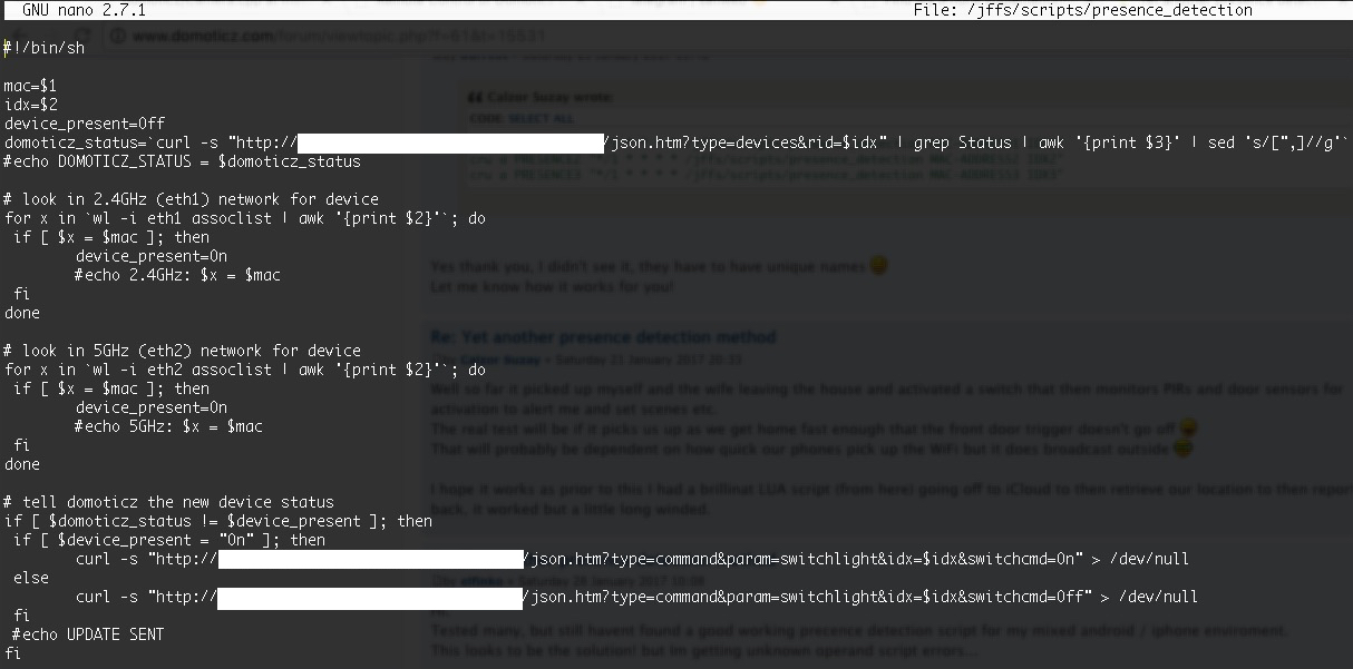

  8. Now:
    nano presence_detection
    Paste this into the file and replace domoticzUser:domoticzPassword@domoticzIP:domoticzPort with the right settings (e.g. domoticz:[email protected]:8080)
    #!/bin/sh
    mac=$1
    idx=$2
    device_present=Off
    domoticz_status=`curl -s "http://domoticzUser:domoticzPassword@domoticzIP:domoticzPort/json.htm?\
    type=devices&rid=$idx" | grep Status | awk '{print $3}' | sed 's/[",]//g'`
    # look in 2.4GHz (eth1) network for device
    for x in `wl -i eth1 assoclist | awk '{print $2}'`; do
     if [ $x = $mac ]; then
            device_present=On
     fi
    done
    # look in 5GHz (eth2) network for device
    for x in `wl -i eth2 assoclist | awk '{print $2}'`; do
            device_present=On
     fi
    done
    # tell domoticz the new device status
    if [ $domoticz_status != $device_present ]; then
     if [ $device_present = "On" ]; then
            type=command&param=switchlight&idx=$idx&switchcmd=On" > /dev/null
            type=command&param=switchlight&idx=$idx&switchcmd=Off" > /dev/null
     fi
    fi
    Again press CTRL+O then Enter to save the file. Then CTRL+X to exit nano.

Thank you for the work on this.
When I try run the script, I get:
admin@RT-AC66U:/jffs/scripts# ./presence_detection
./presence_detection: line 3: syntax error: unexpected "|"
or
./presence_detection XX:XX:XX:XX:XX:XX 19
Any ideas?
Last edited by mehtadone on Wednesday 18 January 2017 19:55, edited 1 time in total.

Hey!
Sorry, it didn't work because I forgot to add the arguments for the script...
I edited the post, should work now!

Ahh I just edited my post. Its the same problem.
Szwuntex
Posts: 9
Joined: Friday 31 July 2015 13:32
Re: Yet another presence detection method
Post by Szwuntex »
mehtadone wrote:Ahh I just edited my post. Its the same problem.
You have to put
domoticz_status=`curl -s "http://domoticzUser:domoticzPassword@domoticzIP:domoticzPort/json.htm?type=devices&rid=$idx" | grep Status | awk '{print $3}' | sed 's/[",]//g'`
in one line without a "new row" as it is in the original code.
You have the same problem in a couple of other rows also.
Yes thats maybe the next problem, Merlin firmware is a bit strange in that way, never had it on another Linux.
It sometimes adds a new line when the line is too long and that gives errors.
If a line is too long maybe you need to enter:
domoticz_status=`curl -s "http://domoticzUser:domoticzPassword@domoticzIP:domoticzPort/json.htm?type=devices&rid=$idx" \
Note the backslash at the end of the first line!

Great. Thanks Surroot. Got it working in the end. Was all line ending issues.
Let see if this is more reliable. Fingers crossed and great work.

elfinko wrote:Can someone provide a copy/pasteable version of the script? Or take a screenshoot of a working version in the nano editor?
The code is the same as in the first post, but as I said in another post, nano on Merlin is a bit strange according to long lines.
Here you have a screenshot:
