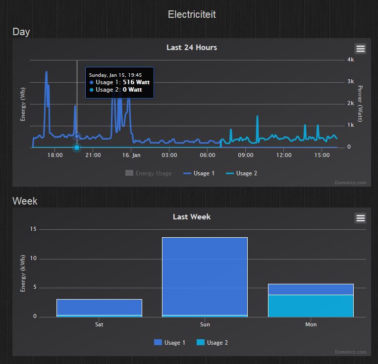

I am having a strange issue.
I added the P1 Smart Cable on my Kaifa Ma105

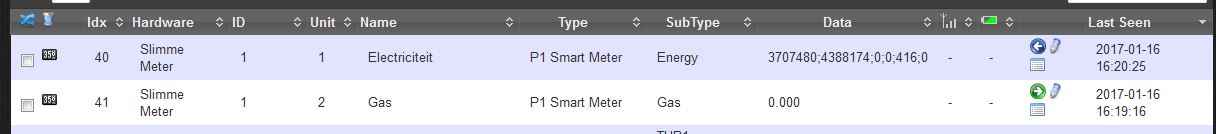

Reading of values is correct, setup of devices too
But the values of Usage 1 and Usage 2 do not show as expected
Usage 2 should be the low tariff value ,
but yesterday the normal value was usage 1 and today the normal value is usage2 (it seems)
Did i do something wrong?
the setup looks ok and incoming envelope too.

zero values on GAS and Return are correct since I don't have Gas or solar panels

looks like my interpretation was incorrect
Usage 1 = low tariff
Usage 2 = high tariff
i was confused because of the weekend values
slimme meter dinsdag.JPG (53.87 KiB) Viewed 1299 times
