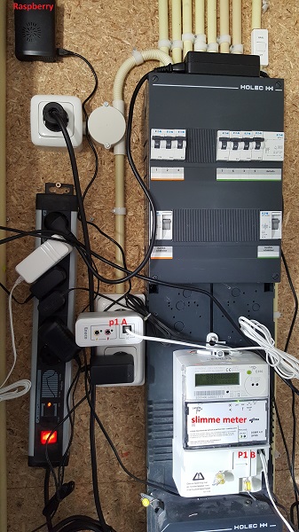

Can you upload a foto of the kind of cables you used to connect toon directly to your Raspberry? This is a foto of my setup.
The P1 cable goes directly to the ''smart meter'', so i guess you need a splitter. Which one? But where do you split it?. At A or at B, and which cable do you need to connect it to the raspberry (usb to RJ11?)
HansieNL
Posts: 969
Re: TOON died within Domoticz
Post by HansieNL »
I bought a p1 poort splitter https://www.iungo.nl/nl/bestellen/i/453 ... t-splitter and a Slimme Meter Kabel https://www.robbshop.nl/slimme-meter-kabel
The p1 poort splitter comes with a P1 cable you can put in P1 B and in the p1 poort splitter input. The Toon P1 cable goes in p1 poort splitter master input en the Slimme Meter Kabel goes in p1 poort splitter slave input. https://www.iungo.nl/images/pdf/iungo-h ... 022017.pdf.
Add hardware P1 Smart Meter USB and you get 2 devices: Energy and Gas.
My meter is a DSMR 4.2 Slimme meter and I had to set it to 115200 Baud in Domoticz.

I went to Okaphone in Groningen and bought me a P1 cable and a pretty dumb splitter. This is the splitter:
https://d1b6tx2agdphz5.cloudfront.net/e ... 3f7327.jpg
Since the smart meter only needs to get 5Volt from one source you'll have to cut one of the cables in the splitter that pushes 5Volt. In my case it was the black one. Aware: the Toon interface only puts 5Volt on that second pin if you actually have something connected. I made sure the Toon interface puts 5 Volt on the second pin; that one will be always on.
My setup is as follows:
Domoticz tablet -->
______________________Splitter --> Smart meter
Toon Interface --->
So, in my case it is more like a funnel :)
