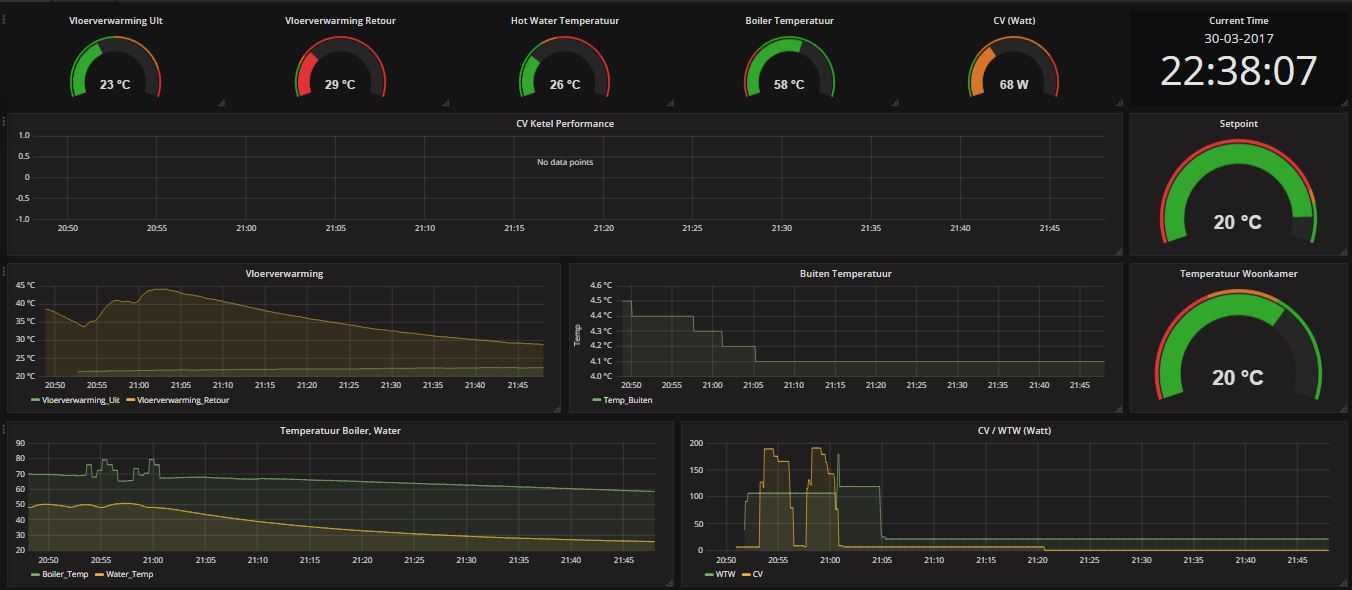

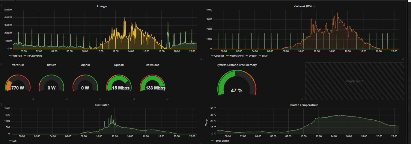

I'm very happy with the possibilities of Influx and Grafana.
General overview
Monitor the CV
Monitoring Ziggo
Pass2php
USB: RFXCom, ZWave, Sonoff 3
MQTT: ZIgbee2MQTT,
ZWAVE: Zwave-JS-UI
Solar: Omnik, PVOutput
Sensors: You name it I got 1.

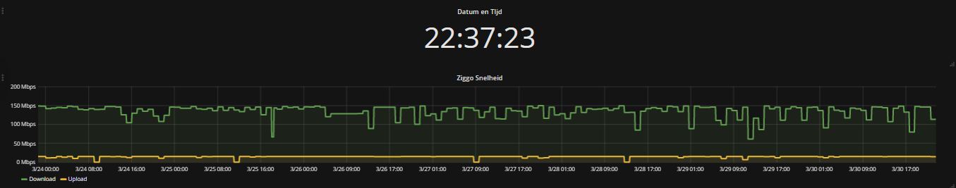

sincze wrote:I'm very happy with the possibilities of Influx and Grafana.
General overview
Monitor the CV
Monitoring Ziggo
Just out of curiosity, How did you manage to implement the Ziggo speedtest into grafana ?
sincze
Posts: 1302
Domoticz version: 2024.4
Re: Grafana with InfluxDB for Domoticz
Post by sincze »
General overview
Monitor the CV
Monitoring Ziggo
I found the instructions somewhere here in the forum and thought it was a nice feature.
https://www.domoticz.com/wiki/Bash_-_Sp ... monitoring
And I just read the file that is creates.
After retrieving the data from the file it is just as any other value. Dump it into InfluxDB ;-) and access via Grafana.
