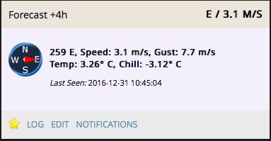

Yes I have read that wiki page, but it was still little unclear how I can use it in this (beginner with Domoticz). Last evening I used trial and error method and got this working in same python script, which get the data. Script stored needed data to variables and build JSON URL using those variables. I add this to cron and now it updates Domoticz dummy device (wind+temp+chill) values every 15 minutes..
# Parsing URL
httpurl = 'http://192.168.1.111:8080/json.htm?type=command&param=udevice&idx=98&nvalue=0&svalue=' + WindDirection +
';' +  WindDirectionabbr + ';' + WindSpeed + ';' + WindGust + ';' + Temperature + ';' + str(WindChill)
# Sending data to Domoticz
r = requests.get(httpurl)
Screenshot 2016-12-31 10.54.41.png (29.13 KiB) Viewed 4627 times
Next I will try Nautilus bash script and also Node Red (I have installed Raspbian Jessie and Domoticz separately). Propably I have same problems with Node Red if I can get it to work at all :). And yes, this script is picked up from Finnish FB group
Nice! Can you show how you did this "Script stored needed data to variables" within the python script?
