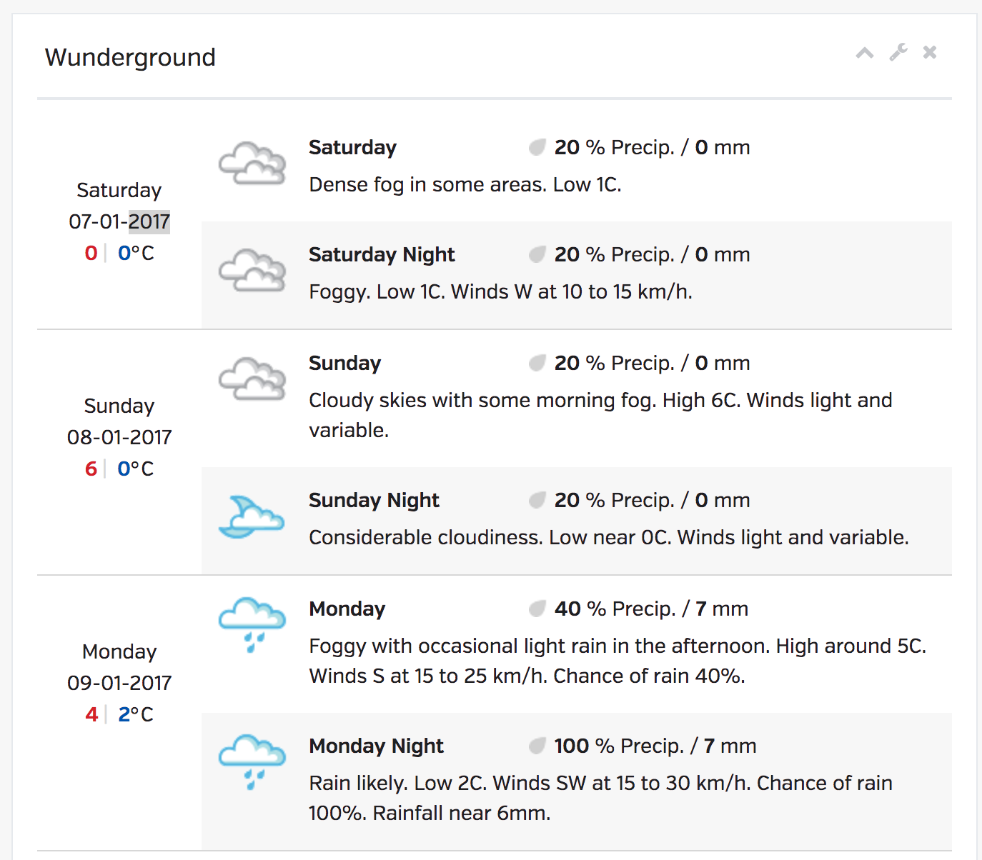

we know about the issue about the yahoo api. at the moment i am writing an weather underground plugin which hopefully will be available soon.
The only "problem" with weather underground is that you must need an api key so i will build this that the plugin will look in you're config if the api key has been given.
a little screen for the current progress of weather underground:
Screen Shot 2017-01-07 at 16.17.00.png (261.26 KiB) Viewed 3295 times

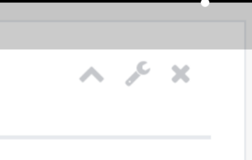

In my browser, I see only the X, not the other two symbols?
Does it depend on the browser or some configuration?

Does it depend on the browser or some configuration? Screenshot_2017-01-07-17-43-20-334_com.quoord.tapatalkpro.activity~01.png
The other two buttons have been removed from Domoboard. They are "old" screenshots.
