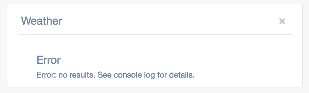

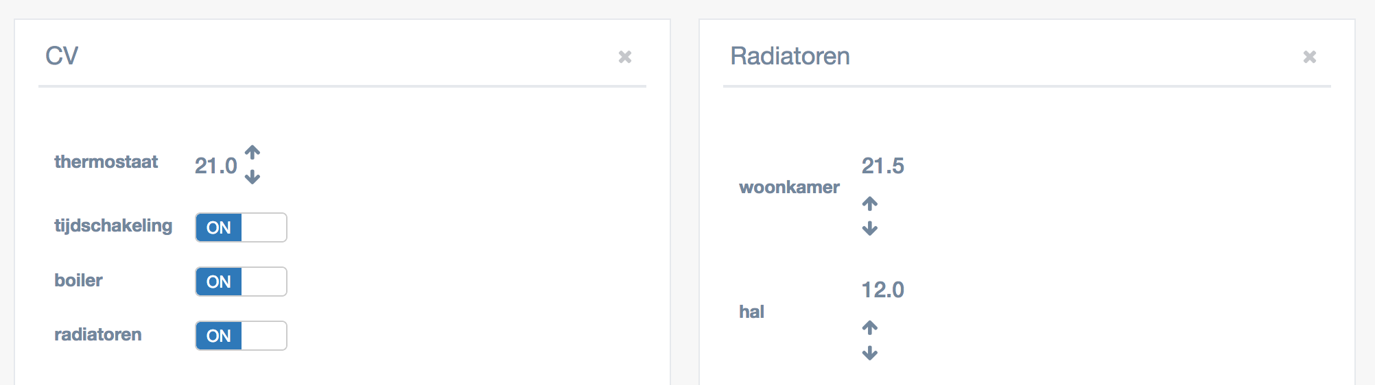

3- reposition humidity info above up/down arrow in small font to create consistent tile size.

8- how do I configure '[verkeer]'?

10- [verkeer] and [icloud] tiles show tool-icon, seems to have no function (yet). Is this a correct assumption?

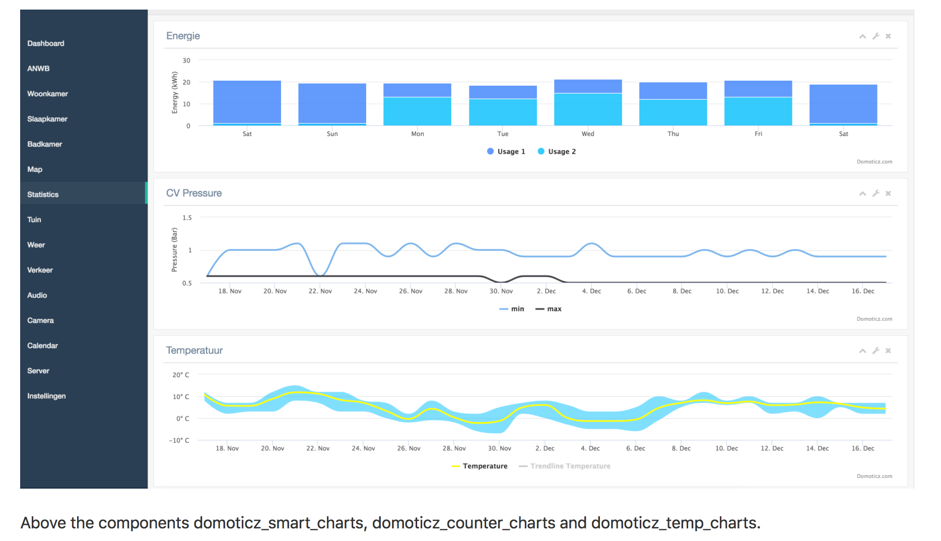

11- On GitHub you have an example showing CV Pressure in Bar. How do I configure this?

Thanks for you're switch and setpoint display bug we will look into that
And the weather template uses the Yahoo API which don't always returns information so we are trying to find an solution for this.
Which example do you mean exactly i can't find it :)
I saw it on your Github example on page https://github.com/wez3/domoboard in the example, the middle one.
I saw it on your Github example on page https://github.com/wez3/domoboard in the example, the middle one. charts.png Using the following in my config doesn't work:
	[[domoticz_counter_charts]]
		Druk = 440, month, pressure
Aah ok that's the counter chart, the config for this specific example was:
[[display_components]]
components = domoticz_counter_charts
CV Pressure = 73, month, Pressure
