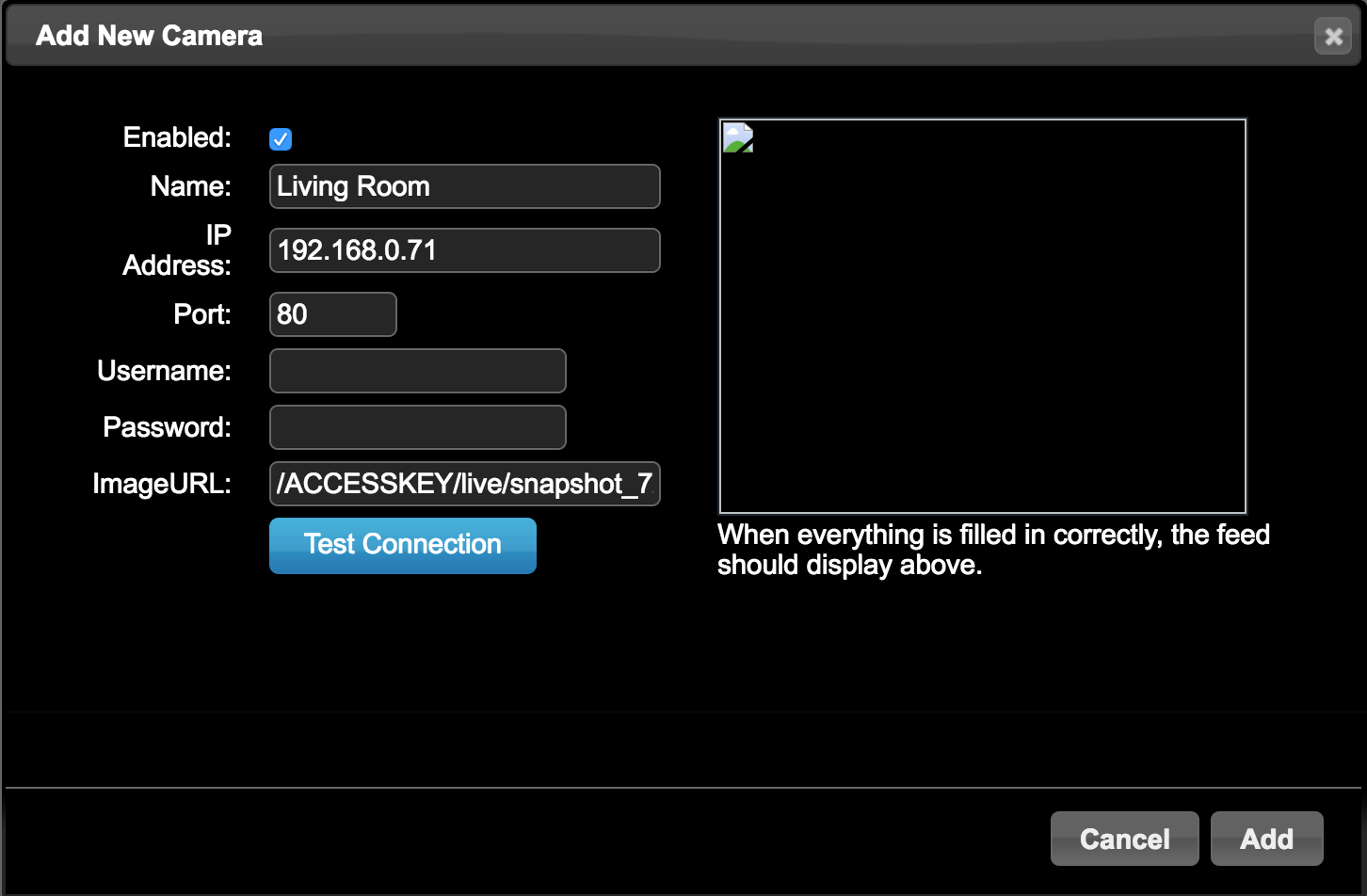

7) In Domoticz add camera wizard, you enter it like this:
Screen Shot 2016-12-30 at 12.12.09 am.png (119.66 KiB) Viewed 29048 times

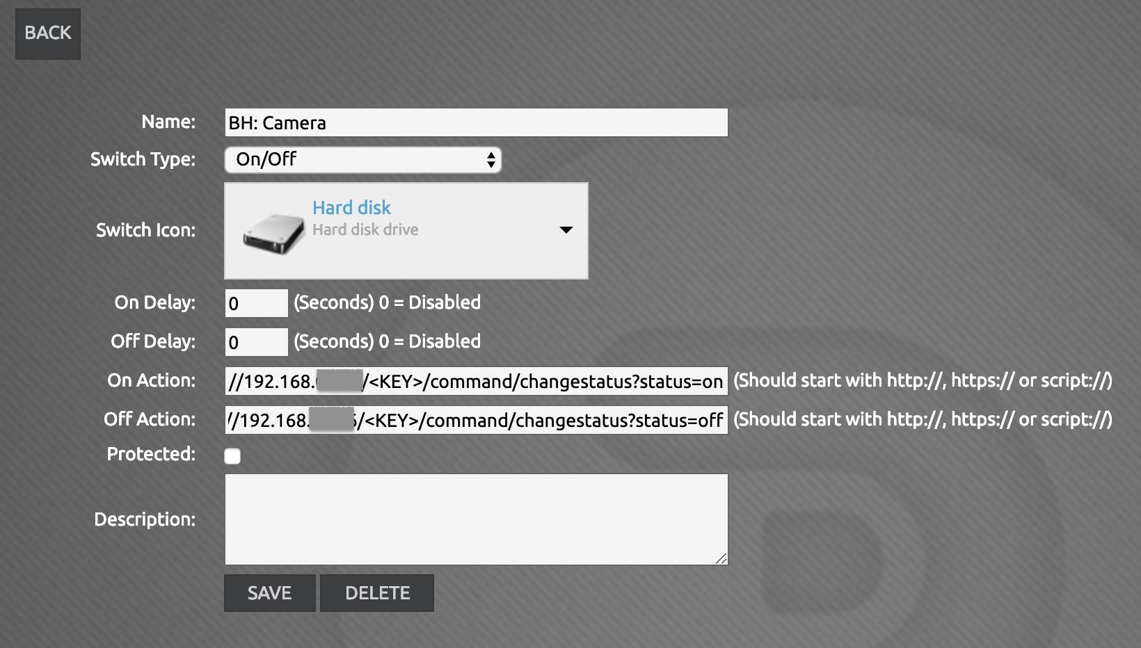

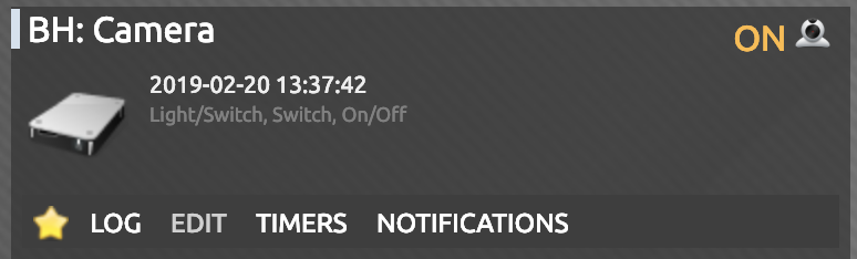

I also added switches to turn on/off cameras from domoticz:
Screenshot 2019-02-20 at 21.41.33.png (90.86 KiB) Viewed 18615 times
Screenshot 2019-02-20 at 21.42.42.jpg (133.09 KiB) Viewed 18615 times
