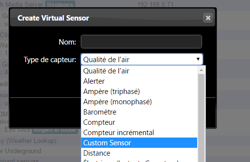

Add hardware type dummy and after that the switches

I found it.... in french "Custom sensor" is translate in "texte"
I'm waiting tomorrow to see if my crontab works.

lepetitnicolas wrote:Thanks
No lepetitnicolas, his name on french is :
http://domo-attitude.fr

Thanks Deennoo.
Now, i see it....i don't know why it don't see it yesterday.... tiredness
but it seems working with a text sensor.
I would try this tonight to see the difference

advantage of a custom sensor is that you can have a graphique to show value (text doesn't do this)
