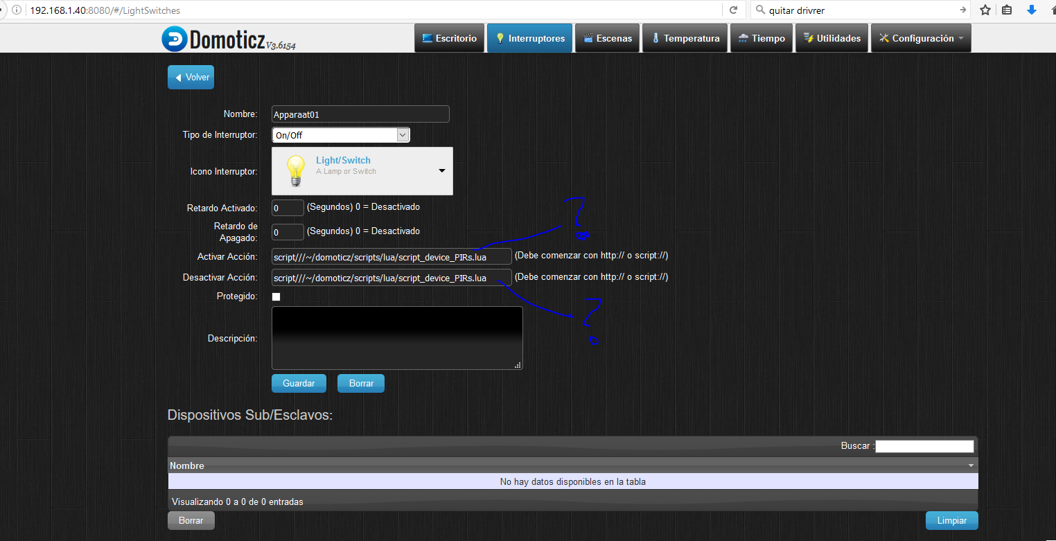

hello
I generate the virtual switch, but do not join with the script command
pi@raspberrypi:~/domoticz/scripts/lua $ cat script_device_Apparaat01.lua
if (devicechanged['Apparaat01'] == 'On') then
        os.execute('sudo -u pi /home/pi/heyu-2.10/heyu on c5')
elseif (devicechanged['Apparaat01'] == 'Off') then
        os.execute('sudo -u pi /home/pi/heyu-2.10/heyu off c5')
return commandArray
What do I do wrong? From console if I execute the command, which executes the script works for me.

if you have the lua scripts runing in the event section with based on changing devices you don't need to put them as actions with the virtual switch...
so just add the part between commandarray to a lua device script under configuration--> events
if the commands work from the command line, they should work through a lua script
but I think you have a typo...
should be
os.execute("sudo -u pi /home/pi/heyu-2.10/heyu on c5")
on my pi I have heyu runing from "/usr/local/bin/heyu"
but if the string works from the command promt there should be no difference in lua when you run it with os.execute
