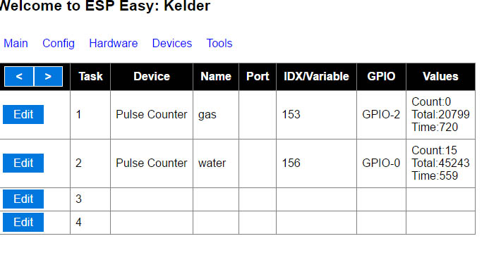

As mentioned in the title I need some help to fine tune utility room reading with pulse counters (connected via a NodeMCU ESP8266) in Domoticz. Please note I’m not an electric engineer, but really enjoy the time spend so far on the project ;-)
I mounted 3 sensors in my utility room. All have been configured as a pulse counter in the ESP Easy firmware and I configured them to communicate with Domoticz via HTTP. Domoticz is getting values, but the representation isn’t good. So I need to troubleshoot the setup. To see the actual details/values see the YouTube.
https://youtu.be/lY-bSa3NFPk
1st question: Can someone please help me out to get the right figures in Domoticz?
2nd question: I doubt when the reed switch is triggered and remains triggerd (gas meter magnet stopped), or the TCRT 5000 sensor remains on the reflectic part (water meter stopped), will the value get a 0? Will it only count the up and down of the pulse?
3rd question: As far I know there is no technical explanation/description available per Domoticz graph/chart (Counter, Counter incremental, Electric (instant+Counter), P1 Smart Meter (Electric), Usage (Electric), etc.... what are the differences? Shall we create a wiki page for it?

I started with the water meter. I found some configuration faults and now the display in Domoticz is correct 8-)
1) The pulse counter TCRT5000 sensor detects on/of and count 2.
no reflective part = 0 (sensor module led off)
reflective part = 1 (sensor module led on)
no reflective part = 2 (sensor module led off)
Since the arrow is counted twice per rotation I corrected the calculation from %value%/2 towards %value%/4
My second question if the pulse counter in the ESP Easy firmware keeps counting in case the sensor is on and sees the reflective part and the water meter is stopped is answered as well.
Check: In Domoticz the count value is correct in the log.
2) In Domoticz the counter divers was 100 I adjusted it towards 1000 since each rotation is 1 liter.
3) In Domoticz I changed the virtual device from RFXMeter counter towards Counter Incremental.

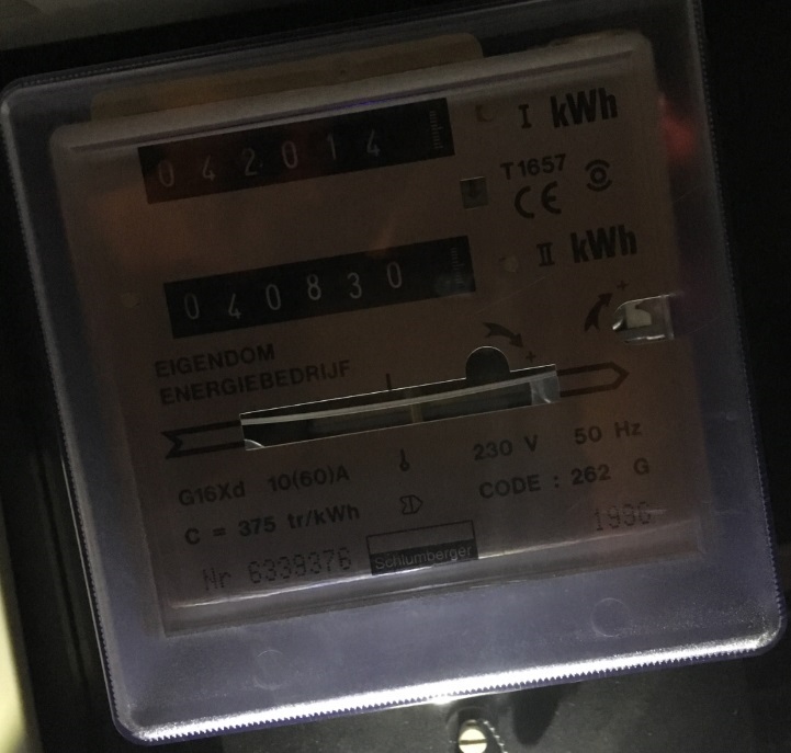

I'v seen that you had some experience with the esp8266 and the energy- and watermeter. Mine Energy meter is a old one with a black part on rotation wheel (375 rotation = 1kW). I did some test with a counter script and have seen that the counter was incremental with 2 by entering and leaving the black spot on the rotation wheel. So 1 rotation is a count of 2, so I think mine pulserate should be (375 *2) = 750 = 1kW
My question is what kind of formula do i need in the esp8266 config for the right results in Domoticz
Meters:
Electricity = Pulse rate = 375 rotation /kWh
  • esp8266 Electricity formula count = (%value%/2)*0,375
    Or something else?
Can you help me, thanks.
Energy meter - C = 375 tr/kWh

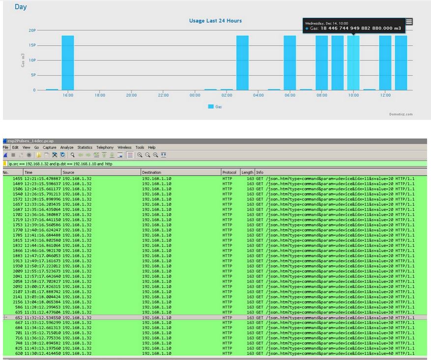

Basically, i have the same issue.
High, non-realistic values. Something wrong in Domotizc logic, for sure.
I took a wireshark trace, and pulses are sent correctly, no mistake there. Problem in interpretation in domoticz.
Im currently looking to startup second Ras2pi with beta Domoticz s/w on it to see if bug is fixed. If no chance, i will have to convert setup to some cloud based services.

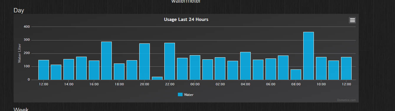

Overview of last 24 hours of the water meter, and i am not home at all last 2 day's
Gas meter same readings i can monitor true the Honywell EvoHome if it's heating or not and that correspondents not with the gas reading ( no other gas equipment at home )
Moday at 07:00 1.060 m3 gas , and no heating :roll:
Both are setup as counter incremental in Domoticz and as Pulse counter in espEasy.

For myself, ive managed to sort out this wrong counter issue.
-Create incremental counter for gas, change its property to 'gas' in "utility"tab.
-set its initial value of Gas counter:
/json.htm?type=command&param=udevice&idx=IDX&nvalue=0&svalue=USAGE
..where usage-=is-in-litres
-on ESP side: FormulaCount = %value%*10 and 'counter type="delta
-on Domoticz side, counter dividers=gas=1000 ( u can go with 100, but i prefer to see 3 digits after decimal, even though, last dignever changes.)
And, off you go!
Bear in mind, my cheap,chineese reed sensor, has habit to stick its contacts close. Ive moved about few mm further away from gas counter to lessen strong magnetic field from magnet. Well,shall see if this helps...
