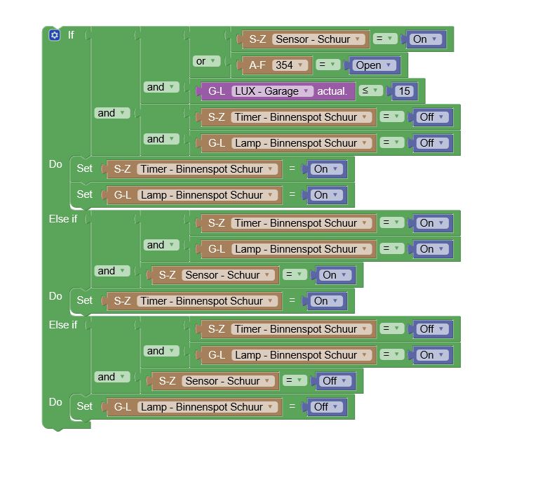

Now I need a LUA guru, because I am a LUA programmer n00b. :roll:
Because of the time delay (blocky response is slow, up to 3/6 seconds). I want to test if a LUA solution is faster. Having no knowledge about LUA, I'm kinda stuck here.
Is someone willing to help me out?
Purpose of this blocky:
I have a fibaro motion sensor and a KAKU door contact (sensor 354).
When opening the door OR motion is detected AND lux is below or equal to 15, the light is turned on. There is a dummy switch with a 3 minute OFF delay. Everytime motion is detected, the countdown timer is reset.

Are you sure it's the blockly that causes the delay?
Have you looked at the time stamps of pir and switch command in the logfile?
If you know PHP you can also use that for this: http://www.domoticz.com/forum/viewtopic ... 23&t=12343
I only have 42msec between pir and switch time :D

I don't know if this will speed up things, but it answers your question I think.
This Lua script should do the same as your blockly.
This one needs dzvents to work. It is worth installing it as it makes lua scripting a lot easier.
The dummy switch is not needed for this script as the for_min(3) will switch the light on and turn it off after 3 minutes
https://github.com/dannybloe/dzVents
	active = true,
	'Sensor-Schuur',
	'354'
     execute = function(domoticz)
     local sensor = domoticz.devices['Sensor-Schuur']
     local door = domoticz.devices['354']
	 local lumi = domoticz.devices['LUX-Garage']
	 local lamp = domoticz.devices['Lamp-Binnenspot Schuur']
		if ((sensor.state == 'On' or door.state == 'Open') and (lumi.lux < 16))
			and (lamp.state == 'Off')
		then lamp.switchOn().for_min(3)
