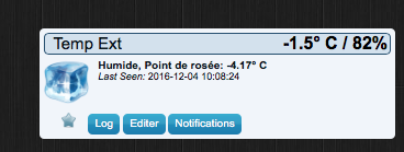

is it normal that temperature is not negative on Home ? and eve too ?
Capture d’écran 2016-12-04 à 10.22.19.png (32.05 KiB) Viewed 3411 times
thanks

Post by G3rard »
Here it shows negative values in both Home and Eve app.

G3rard wrote:Here it shows negative values in both Home and Eve app.
thanks
so i thinks it's my install
i try to reinstall
Thanks a lot
