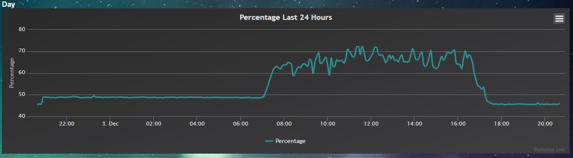

Looking a way to maximize the data that my cameras are getting, I found a script that can measure the percentage of light that camera can read using the following pyhton script and a virtual percentage sensor.
You have to change/remove username:password on what you have saved on your camera interface for user access.
Also <DEVICEID> is the idx of percentage sensor.
You will also install imagemagick.
The mechanism is to resize image to 1 pixel and measure the percentage of light on this pixel.
credits go here: https://matdomotique.wordpress.com/2016 ... camera-ip/
