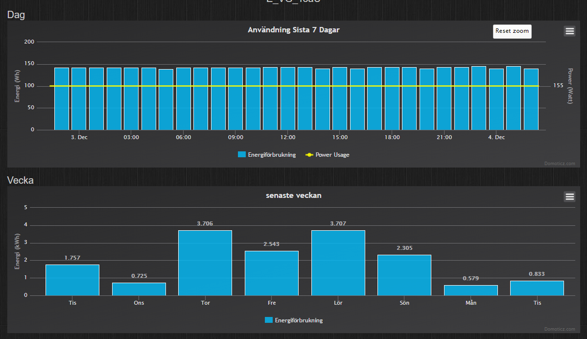

I have a floor heating in my bathroom, where I control the heating from Domoticz. That means Domoticz knows when the heating is on or off. To the heating a dummy meter
is associated, type: “Electric (Instant + counter)”, controlled through LUA-scripts.
The power usage is 155Watt.
That means the theoretical consumption for the heating is:
12,9 Wh for 5 minutes
155 Wh for 1hour
3720Wh for 24hours
[img]
Graph 3Dec.png (133.03 KiB) Viewed 2404 times
[/img]
I have here zoomed in 3 dec, that corresponds to the daily consumption for Saturday (Lör).
Some notes:
The power usage during the whole period is 155Watt.
The hourly consumption is about 142Wh
The daily consumption based on hourly values are
139*1 + 140*3 + 142*10 + 143*9 + 145*1 =3407Wh
The daily consumption based on the bar graph (Lör) is 3707Wh
Compare that to the theoretical values.
The theoretical consumption for 1 hour is 155Wh, the bars are about 142Wh missing 13Wh which is 5 minutes consumption.
The theoretical consumption for 24 h shall be 3720Wh
The sum of the hourly values gives 3407Wh. If you add 24*12,9 it is 3717Wh, which is almost as the theoretical value.
The graph for daily consumption is 3707Wh. If you add 12,9Wh for 5 minutes consumption it is 3720Wh, which corresponds exactly with the theoretical value.
My conclusion is that the 5 minutes values are correct in the database, but when calculating the consumption the last 5 minutes in the periode are missing. It is when calculating the hourly consumption and also the daily consumption that is stored in the database.
Could that be the case? And is it a “problem” just for me?
