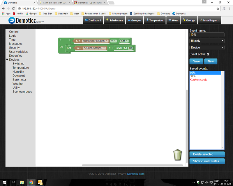

Tried this,,, doens't work
In Blockly I can dim the light biy pressing a switch... very strange. Seems to be a fault in the command: set level

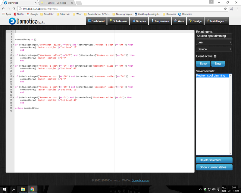

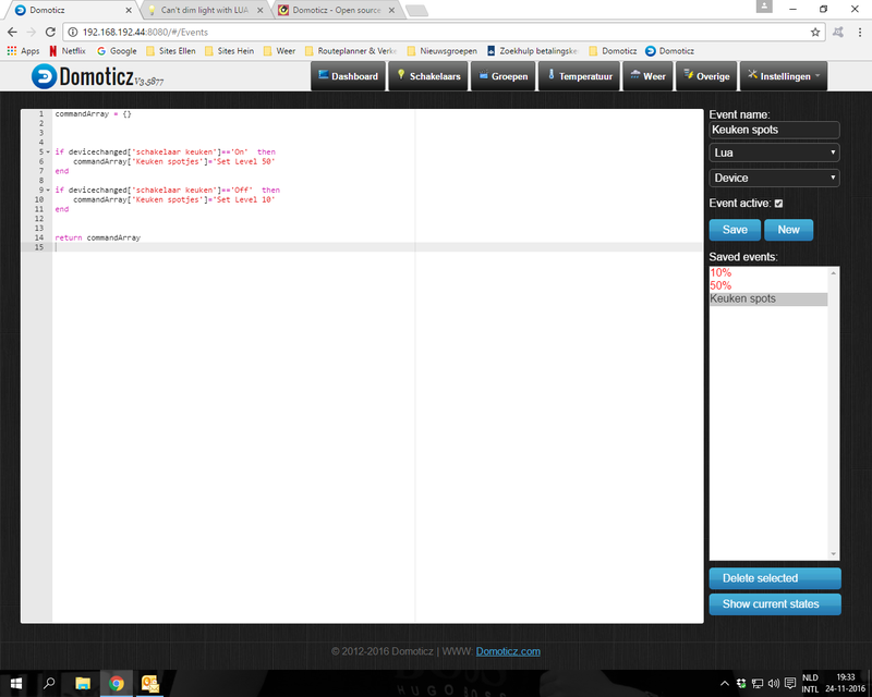

Typed everything again.... it works now...
I can put the script down, if someone wants to have it.
